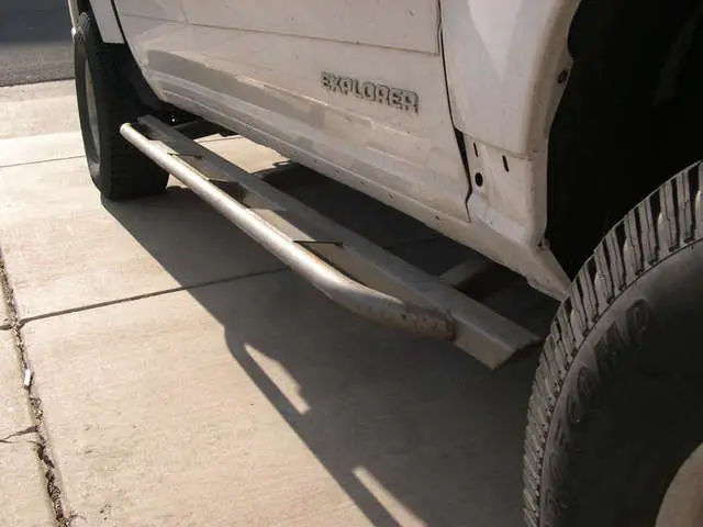

I tell you what, mine even get like this a little.
Thanks Colin! :thumbsup: It helps with the pics. I was less than thrilled with the welds, and spraying the underside (grey as in the pics) is a pain without a full lift to get under there. They sure look alot crappier in picture than I'm used to in person :( but that gets me motivated.
Its also that my tires are wide enough that rocks and crap get thrown up at them and pitted the paint, which then brought rust.

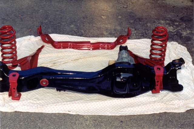

As the others have said the best you can do is coat the underside to lesson the damage.. I have used Por15 for many tasks and it is a VERY durable surface.. When I was restoring my TTB I used rustoleum @ 1st, but quickly found that it would scratch/ chip when simply moving the parts around :thumbdwn: Por15 is easily 10x the durability of a paint product. :thumbsup: check out Paint vs powder coat I wheel my truck and it gets scratched, but only the scratch will rust; the rust doesn't get under it and flake it off like it would with paint. There are several other companies (Eastwood, KBS Coatings..) that make similar products..
