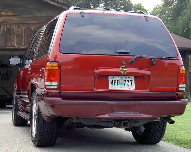

Ditto, and get a Hidden hitch, you won't like the other's being seen under the bumper. The round tube version is hidden, the later version is square tubed, it shows, and it's for 16" wheels. I have the older version, plus a large spare(I cut my hitch to fit it, 20 minutes). Good luck,
