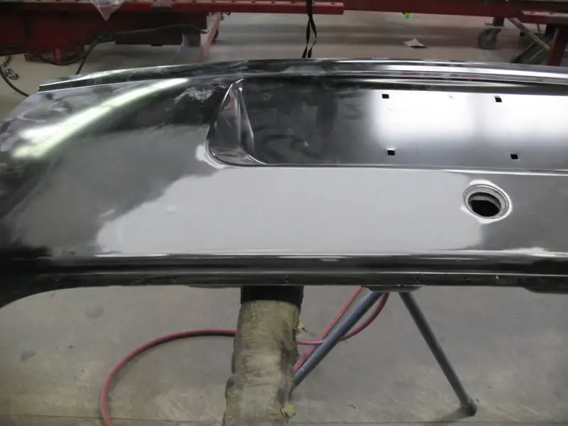

Here is my new liftgate ready to go.
Here is a close up of the holes I wish to fill. I did not have the time to engineer a way to shave the lock / glass popper. If I had thought of something I would have.

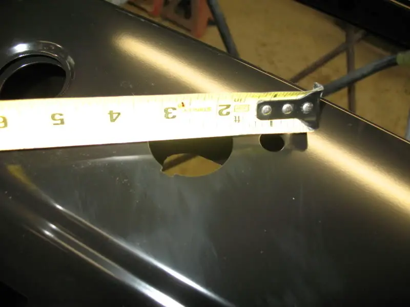

Step one is to measure the holes I wish to cover so I can cut a metal backing. Never use duct tape or any thing like that to back up your body filler no matter how small the hole. Such steps are very unreliable. Remember, measure twice cut once.
Keeping it in the family I cut the backing metal out of my old lift gate. Silver sharpe makes a fantastic marker for doing lay out work like this.

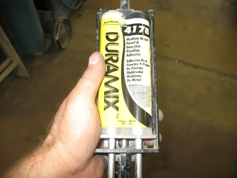

Now to attach the backing plate most people would weld the metal plate on. Welding however creates tremendous heat and will warp the metal making for MUCH more body work. The key for that would be using several small cool tac welds and cooling the metal inbetween each tac weld. Very very time consuming. I opted to use a metal bond. Dura-Mix 4178 is a metal bonding adhesive that is used in this trade to glue sheet metal together. I was very skeptical too but have become quite a fan of this product. Let me guarntee you this stuff will hold a quarter pannel in place no problem. I think my backing plate will be a non issue.
I held the backing plates in place with some masking tape and let the dura-mix dry over night. Went home and got some dinner.
This is how it looked from the out side. Note how I cleaned up any dura-mis residue.

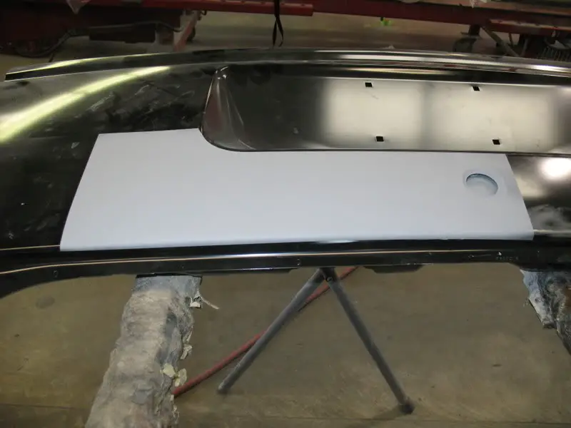

Here is the end results of the body work.
Prime
Sand that down with 320 and it is ready for paint.
