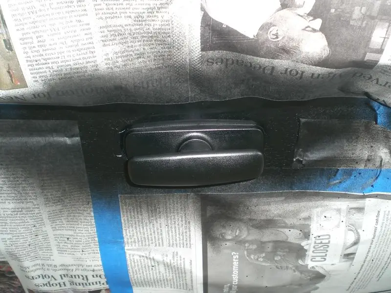

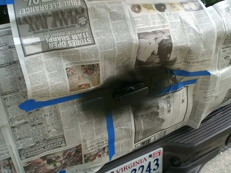

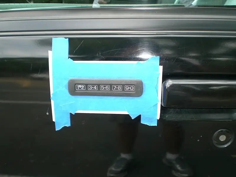

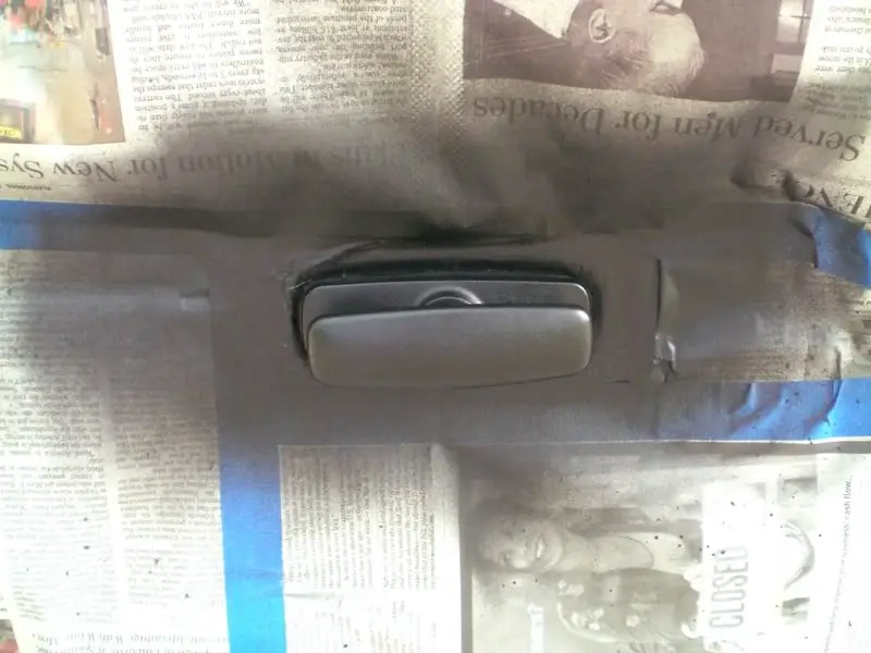

i took out the wiper cowl, masked the rear hatch handle, took out the rear hatch glass handle, masked of the keypad entry system on the drivers side and started cleaning them by wiping everything down with mineral spirits.
after that i started masking all parts thats not supposed to be painted like the rubber lip on th wiper cowl the actual keypad of the keypad entry system, and all surrounding areas of the rear hatch opener and drivers door.
Time to spray away... i srayed a mist of the trim paint on all the stuff that i was trying to restore and waited for it to get dry to the touch but still tacky. spayed light coats at first letting it dry thoroughly then started to aplly heavy coats till i finished out 1 can. Let it dry before installing and you will be rewarded.

rear hatch and keypad frame:

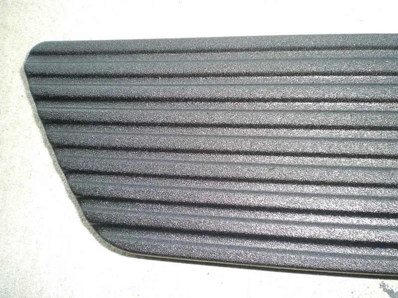

The bed liner is for the running board steps. since is a non slip type of finish and is designed for the abuse that a truck's bed liner gets, i figured it would be suitable for this kind of application.. pics of this to come..

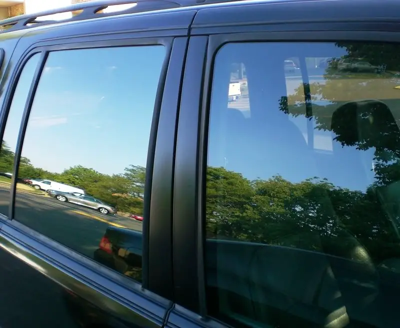

Door (window) pillars i went for the oem satin/matte/semi-gloss look
Before:
they were not really in bad shape but if you really look at it you can see a couple of signs of wear.
here you can really tell its faded and the color is far from black. got a scratch in there too.
the side area is already showing the metal part
time to paint..
still a bit tacky
the final result.. imho, it looks awesome :D
with flash

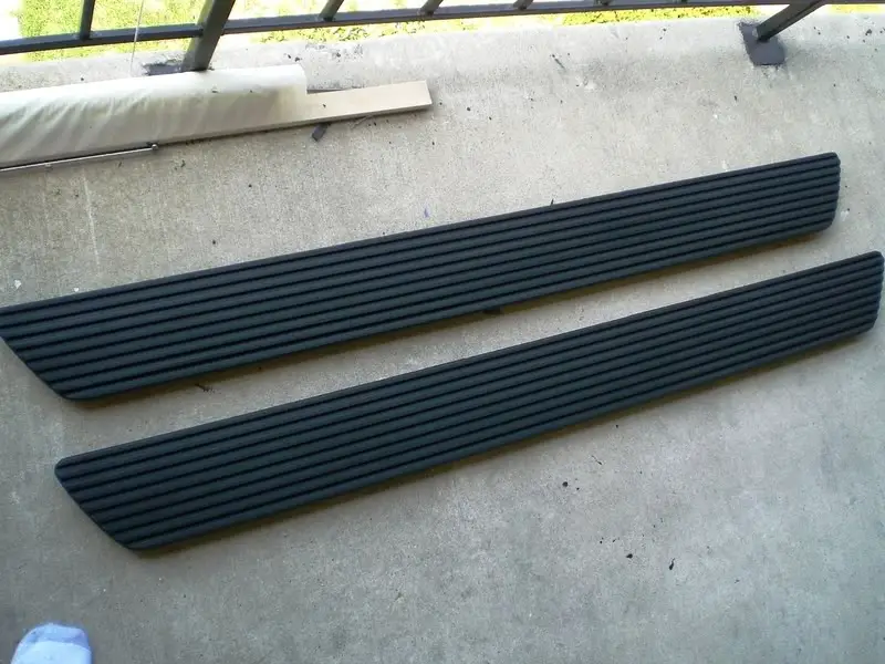

Running Boards
*FYI to remove black step portion of the running boards, youll need a 8mm deep socket and knee pads (specially if you dont have a garage like me)..

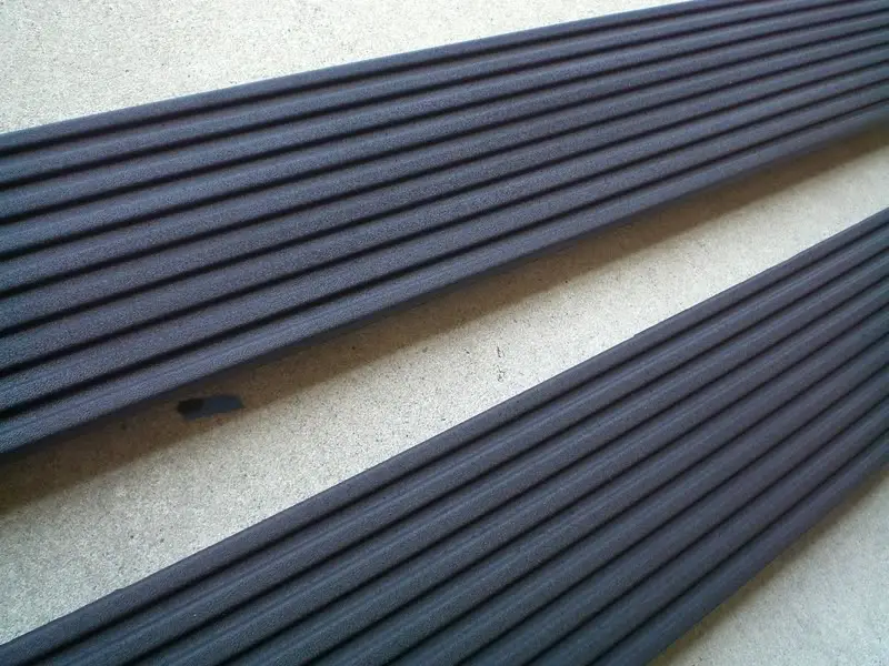

Before: again, not too faded but definitely grayish.
1st coat with dupli-color truck bed liner
drying out before installation.. i used a combination of truck bed liner for texture and bite, trim paint to add that oem dark color and clear top coat for extra protection and to give a little bit of shine
close ups
see the bed liner texture? i love it..
reinstalled

*FWIW* For pristeen results I would not use news paper as a mask, I would use pasking paper desinged for paint. The reason is the pro stuff will absord and hold the dry paint more. With news paper the dry paint will blow off when you add second and third coats, adding dirt to your finnish.
That said your results still look fantastic.

That's true MONMIX. but for right now as a low cost fix for textured trims newspaper works pretty well :D .

Hey parad1mg, i was wondering. Exactly what type/brand of spray paint did you use on the window pillars? Yours turned out great
heh cause mine needs it BAD
i used krylon fusion black semi-gloss on mine, took a few coats but works great
I used Krylon texturized paint on my door pillars and a few other things too and it looks great,
