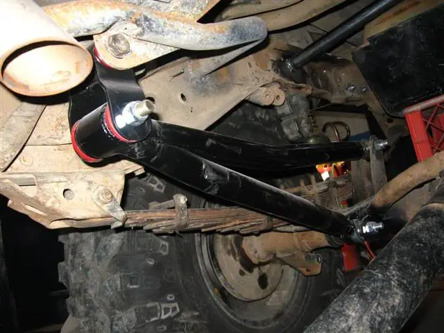

Redesigned antiwrap bar for the rear axle;

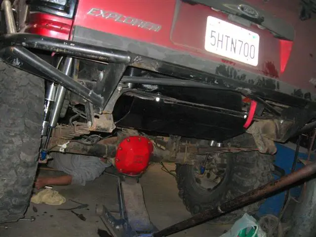

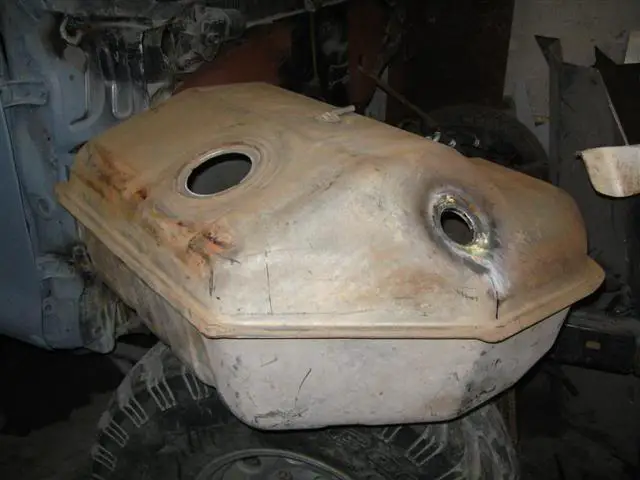

Bronco II gas tank;

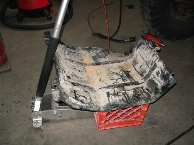

Gas tank skid plate;

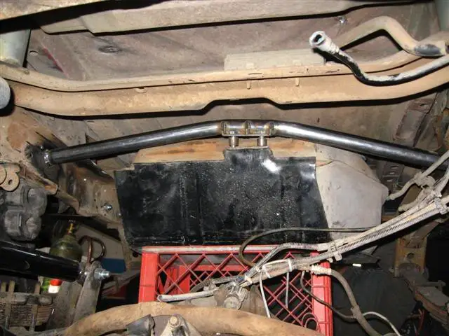

Gas tank cross member;
Tank install;

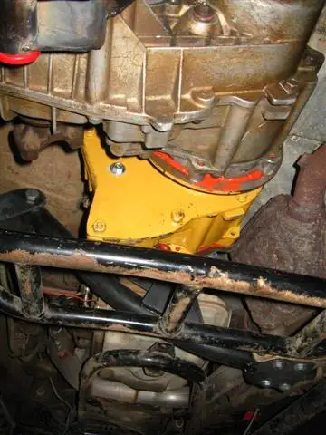

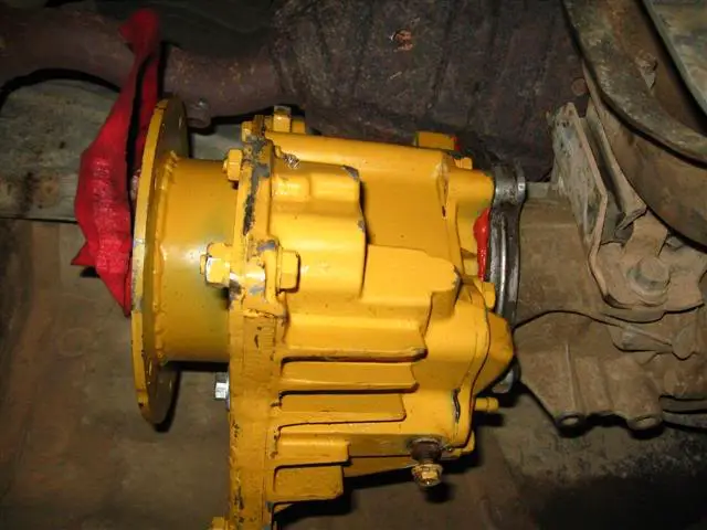

Doubler on trans;

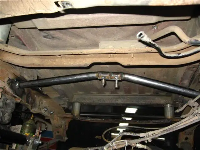

New trans cross member (shiny black paint)
Cross member/Trans mount;

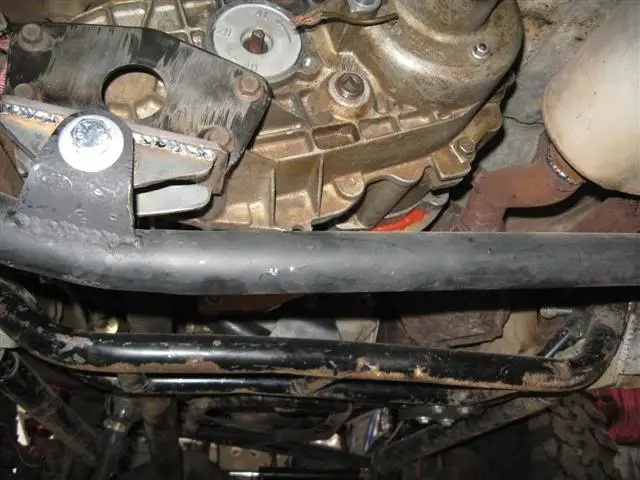

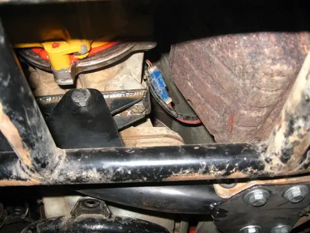

New T-Case cross member;
T-Case mount;

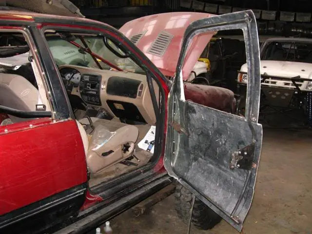

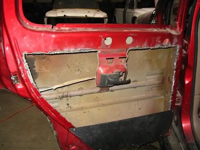

Cut out rear doors;
Fiberglass front door & frame;
Front doors;
Tank from back;
