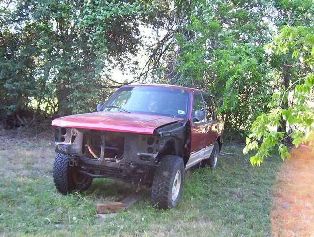

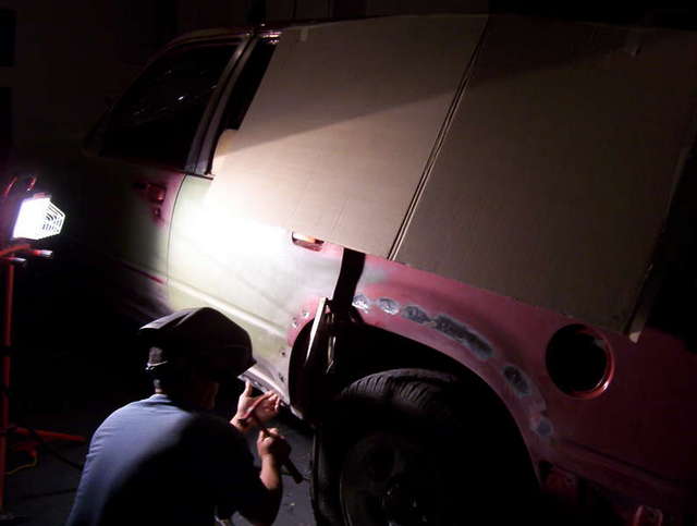

yes I am much further along then the Thread Suggests. since we are on the subject of Body Swaps lets go in to the Transplant part of the thread...
I wont go in to how Gross the previous owner was. The interior was Nasty gross stinky...
I will post up a quick couple of pictures of body work that needed to done...
I dont wanna hear how unsafe my body Swap was... Its all I had at the time.. :D
98 body on 92 frame...
spaced out body mounts..
my bent 98 frame he he...
Stay Tuned more to come...
