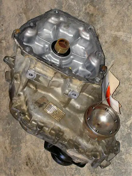

I was eying the BW4410 that you have, for my 5R55E. It took me a while to learn that in 2002 the whole trans case changed, and that BW4410 has to be used with a 2002+ trans, and a 2002+ PCM. Good luck with that,

There have not been many trucks on here with AWD that had more than about 350hp. Jon has been right about there for a long time, and he just swapped to the 4WD BW4406 case.
Someone who has been inside one may know better. I had asked a rebuilder a few years ago, they don't know. If the weak link is the viscous clutch than I'd say that just the lifespan would decrease, not a catastrophic failure of that. But like any transfer case there are other parts there which will be weaker than a simple 2WD output shaft.
I'm betting that the BW4406 will be strong enough for me, because a friend here has had success with his 2003 Explorer(auto 4WD) and a strong supercharger. Alex has been likely over 450hp with that, and he is moving towards a turbo if things are still the same.
