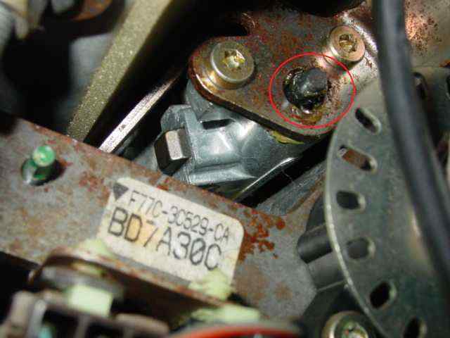

Yea, anyone else noticing their gear lever becoming increasing hard to get into gear properly may want to check these 2 bolts.
When you did yours, did you happen to notice this greasy black rod? Looks like something should be covering it.
nothing covers that rod its actually a guide rod to line things up those bolts coming loos is a common prolem on a lot of fords especially crown vics and marquis i have an 03 marauder and my bolts were coming loose constantly next time they come loose try a lil dab of blue loctite that will keep them tight
sorry about my last post crappy wireless keyboard it should have started nothing covers that lil rod

That picture about does it-you'll see the steering sensor ring when you look up there-
There are a few of those bolts up there-but it seems to me the top one is the one which was loose.
