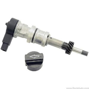

RockAuto.com has the following listings:
Camshaft Synchronizer:
DORMAN Part # 689101 (Includes Allignment Tool) $40.79
Crankshaft Angle Sensor:
A-1 CARDONE Part # 30S2800 (w/ Step on Plug) $49.79+$40.00 Core
A-1 CARDONE Part # 30S2800L (w/o Step on Plug) $49.79+$40.00 Core
wrong photo
It looks like RockAuto used the camshaft sensor photo for the crankshaft sensor. The crankshaft sensor tells the PCM when the position of the #1 piston and doesn't look anything like the photo. Its located adjacent to the crankshaft damper/pulley.
The first pic and discription is the part you want.

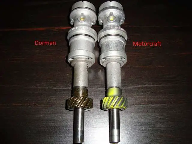

I arrived home this evening (technically yesterday evening since it's 1am now) and the new camshaft synchronizer had arrived. I thought I would snap a few pics of the Dorman and the Motorcraft. Look carefully at the closeups of the pins in the shaft. You can see that the Motorcraft pins are thicker. The Dorman also has some side-to-side play in the shaft.
I came home from class yesterday and the rest of the install went great. The X is now screech free. I would have posted last night, but our power was out due to a huge wind storm. I'm posting this from school.
