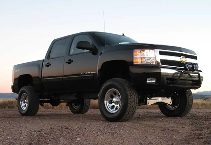

Also a word of advice, it seemed like all of the 2wd owners, like myself had an issue with the upper control arm (front) being bent downwards at an extreme angle, even with only a 2" spacer. Causing issues with suspension travel, not only causing an extremely rough ride, but ball joint breakage issues. Some 4wd had the same issue when using a 3" spacer. Some one really needs to make a lower control arm drop bracket to go with the lift spacers. All the other companies do. Then a 3" or larger spacer would pose no issue. I have seen a Silverado using 6" strut spacers with a drop bracket, rode just like factory too. That was it for the front lift. Drop bracket and strut spacers.
(Drop bracket for Silverado shown)
If you make a drop bracket to go with them I want 4" front spacers and 2.5" rear. SO HOW ABOUT THAT IDEA?
I want to lift my truck and run 33" or larger tires with my current 20's, but I don't want the issues I had before.
drop bracket lifts like that require a spacer (or taller strut/coilover) and a taller spindle height to alleviate the bad upper arm angle. now you're talking about a $2,000 lift as opposed to a simple spacer.
