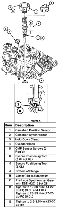

Yeah forgot to put this diagram i found on here.
But is the synchronizer a whole piece that i can slide out, or do i need to take off more parts of the engine to free it?
or can i just disassemble the top where it is messed up.
You have broken plastic in there. I think the whole syncronizer needs to come out before you can clean it (or replace it).
Spray the base by the block with PB Blaster. Remove screw and clamp "3" (from the exploded view).
Then pull it straight up. Eventually tap it gently with a hammer to dislodge. It's just pushed in with one O-Ring around.
Look here, it is one taken apart form a 5.0L.
You will need a special alingment tool to put it back.

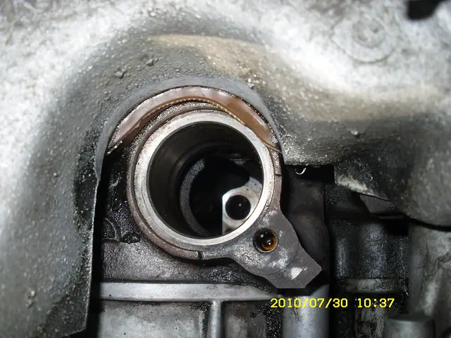

Yeah you need to replace the entire camshaft synchronizer. Get some sort of manual so you do it right. After you remove that one hold down bolt at its base the whole thing pulls straight up out of there. It may take a lot of pulling. PB Blaster is your friend and don't go banging on it unless you're using a slide hammer. Here is a picture of what it looks like after you remove it:

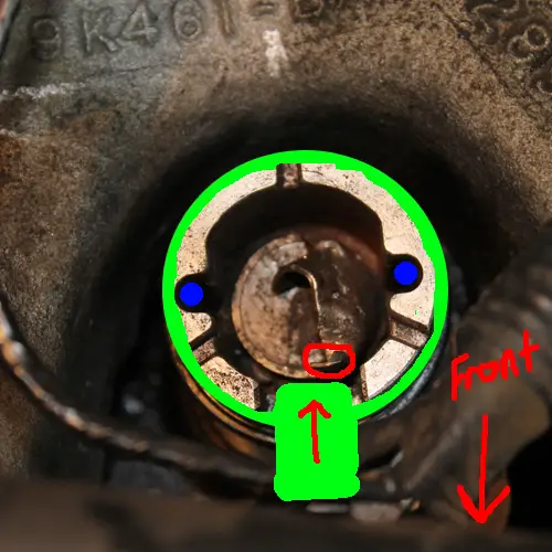

By finger/flag, I meant the vertical part on top of the synchronizer that rotates and passes by the camshaft sensor to generate a signal. Looking at your picture, it appears to still be intact. In your picture that shows the damage, it's located at roughly the 7 o'clock position.
Keep in mind that pistons are at TDC twice during a revolution. You need piston 1 to be at TDC on the compression stroke. With the sensor removed, rotate the engine manually by the crank pulley until the "flag" is pointing directly forward. If the alignment tool fits, then you are at TDC on the compression stroke. The alignment tool will not fit any other way. If the tool fits, remove the entire synchronizer assembly, taking care that the entire shaft comes out of the hole and isn't stuck to the oil pump shaft. Do not rotate the engine once you remove the synchronizer. Place the alignment tool on the new synchronizer and slide it back into place. Again, the tool will only fit one way. It's hard to explain, but you'll understand completely once you have the tool in your hand. When you reinstall the synchronizer, the arrow on the tool should be as forward facing as possible.

Back to the OP. I modified one of your pictures a little. Imagine the green portion as an outline of the camshaft sensor. The blue dots are the bolt holes. (Which brings me to another point. I don't know how your camshaft sensor was pointing another direction because the mounting holes wouldn't line up unless it was 180* out. In that event, it would have been pointing toward the rear of the vehicle.) Anyway, back to my highly professional diagram, lol. The flag/finger is the part circled in red. It should line up perfectly, or very close to perfectly, with the middle of the opening in the syncronizer's body, as indicated with the red arrow on the plugin of the sensor. As I mentioned before, if you have the installation tool, it will make things much clearer. I'm not the best at explaining things.
