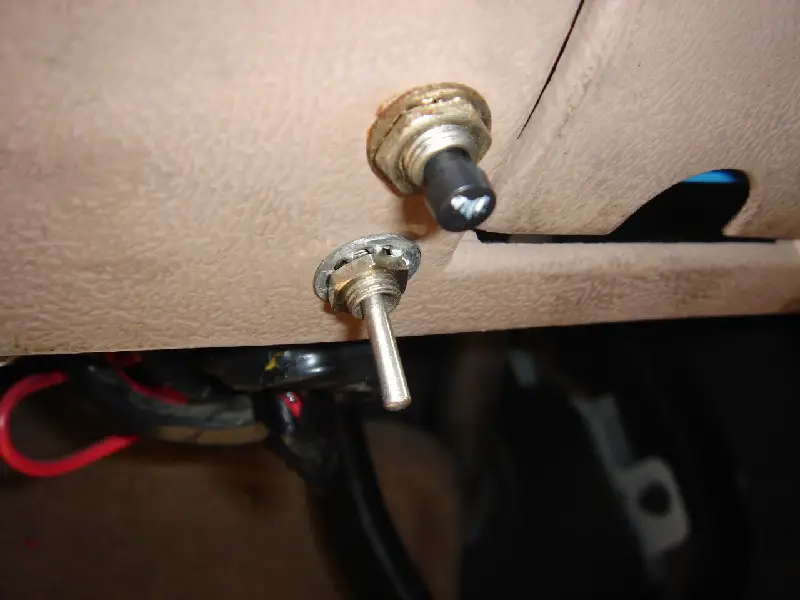

I don't know if This will help you or not. The past week my son's alarm has been haunted and none of the remotes will work. We unhooked the battery and waited a while and then hooked it up. Of course the alarm goes off when you hook it back up. In our case the remotes then started working again????.
At least it works for about 24 hours.
We have also found that if we hit the over ride switch and turn the key on the alarm goes off and then the remotes start working again.
The over ride or Programing switch as sometime called is a small black push button located hidden (or not so hidden) under the dash. I have included a photo of my setup on my 97. It also has the valet switch. My son's EX has his button well hidden under the dash near the floor heater and the center console. I know it is there and still have trouble locating it. in his case the Valet switch is a push button located in the red led
I have learned over the years that it seems that none of the Ford alarms are the same. Of our three Ford vehicles two have 3 button remotes and on is a 2 button remote.
Of course there is also just the door remote / theft which honks the horn and then the alarm system that has the siren speaker.
I've gone on too long. See if you can determine what alarm system (model) that you have, how many buttons etc and post ot back up to see if anyone can help.
thanks SO much for the reply/effort Don... i have the 3 button fob... the alarm is for keyless entry no remote start... there is def NO switch like the one in the picture although i would be OPVERJOYED if it were like that lol i laid on my back with a flashlight and could not find a button, im going to get my small friend to try to find it hes 5'5" and like 120 like a half me lol, my wife was under there but she couldnt find it either... is there any way to totally disable the alarm?? i highly doubt it but its worth a shot, i doubt someone would even try to steal it and i dont keep anything valuable in there, it has a blue hatch(i backed into a flatbed at work sometime ago lol and the JY only had a good one in blue) maroon rest of it with dents in the hood, and improvised "hood pins"(long bolts with wing nuts)because i left the hood unlatched after a jump start a few years ago and i didnt wanna spend the 15$ on my beater lol its also annoying and loud while running with something screeching from the serpentine system while you drive it lol but it was a dependable, comfortable vehicle with 4wd plenty of cargo room and gets better gas mileage then anything else in my fleet, been driving my 02 Silverado Z71 WAY too much because the "exploder" is down :thumbdwn:
