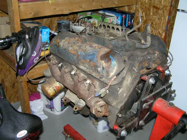

New motor for the '66. Existing one has a rattle associated with the camshaft that I (and several mechanics) can't track down as to what is causing the problem. The cam keeps walking backwards in the block, which is odd for Fords, they usually walk forwards if not constrained. Serves me right for not building the short block myself the first time.
This will be a hotter version of the existing motor. More agressive cam, stronger bottom end, etc.

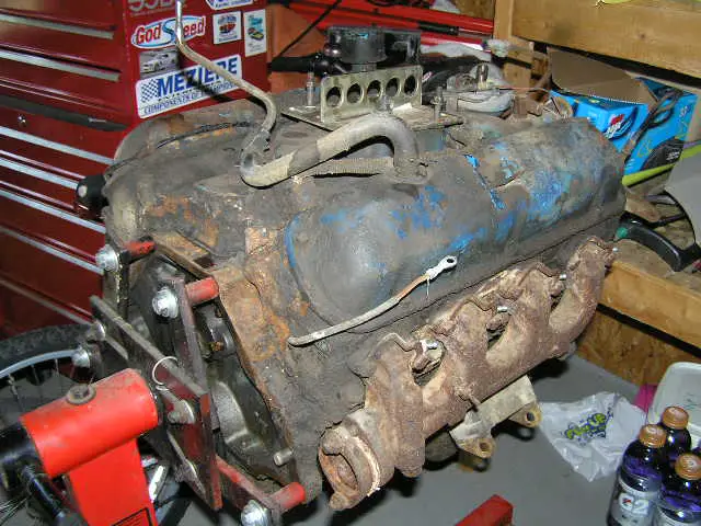

The motor is an original early '66 289 that looks like it's never been cracked open. Still has the original tags on it and the bolts and gaskets appear to be undisturbed. Turns over smooth and the oil in it looks good. Teardown will commence soon

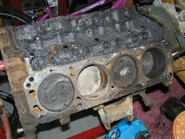

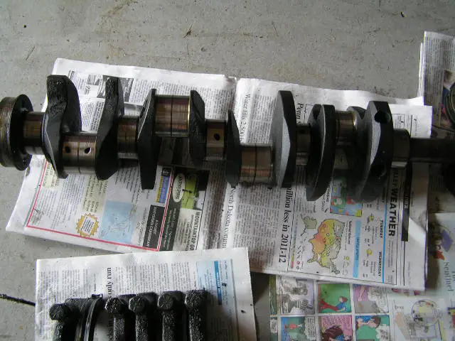

Fortunately, the bottom end is in a lot better shape than the top end. No scoring on the cylinder walls and no damage on the pistons. Crank *might* need an 0.010" turn. Definitely needs new wristpins. I'm hoping that I can get away with a hone on the cylinders and re-use the existing pistons. Guess we'll find out when it goes to the shop.

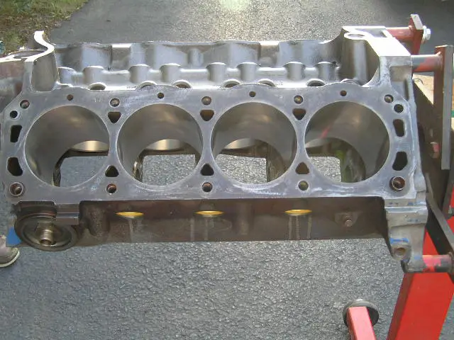

Took the block, crank, pistons and connecting rods down to HP Engines in Thompsontown, PA today. Did a quick measurement on the cylinder bores and we're going to have to do an 0.030" bore on them. Cylinders were worn from .018" to 0.021". That means we'll be putting in new forged pistons now

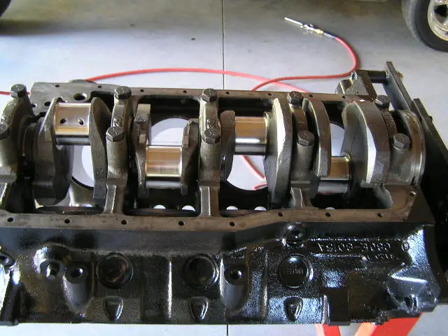

Assembly started.
Crank installed:
Piston assemblies and rings laid out in the proper order so I don't goof
Rings assembled onto pistons:
Installing pistons with covers on the studs to protect the crank:
Plastigaging everything just to be sure:
Got to the # 8 piston and broke a ring in my ring compressor...:fire::fire::fire:. The compressor had fought me all day, and since I broke 1 ring, I was concerned about the condition of all the other rings, so I yanked all the pistons back out..
Thankfully, all the other rings were fine and now I've got a better ring compressor and new rings for the #8 piston on order.
Stay tuned...
