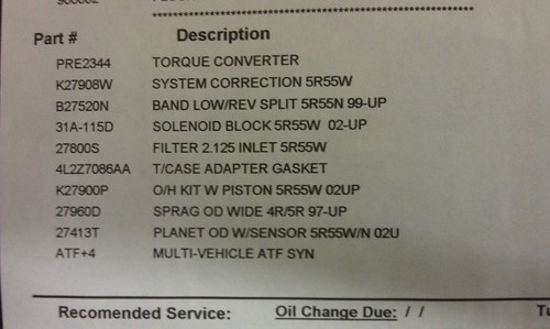

Here is what was put in it last Jan...
Explorer transmission rebuild parts list by billyssingle, on Flickr
Anyone see anything missed or skipped that should ask about?
I know the trans takes mercon V why does it say atf +4???????
