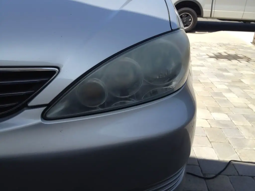

I did a search and didn't see anything on this product, so here is what I have.

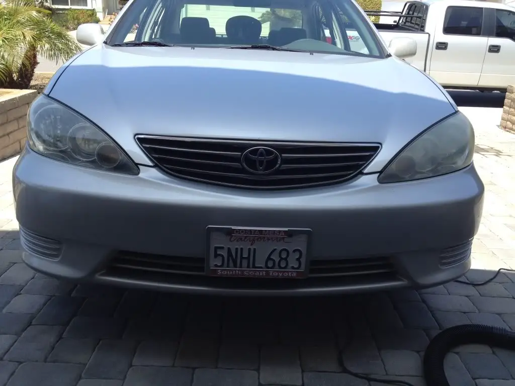

My wife's '05 Camry's headlights were pretty fogged over. Her dad had the Mothers product already and told me to give it a try. I have always been skeptical of things like this, but I finally got around to it today and the stuff actually works. These pics are after just a quick passover and I'll be doing it one more time to get them real nice and clear.
I didn't get the camera (phone) out until after I did the first one was already done.
Comparison:
Before:
After:
I like you am a bit skeptical of these things too, but your pictures don't lie. It's real sad to see headlights that are only 7 years old to be so foggy. My mothers 2000 Jeep has piratically yellow lenses. I think I may buy some for her, and give it a try.
