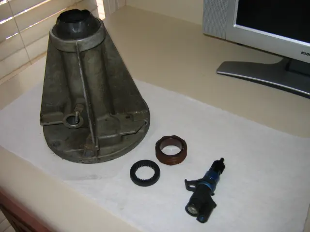

Well, the verdict is in. The current gear is 20 teeth (black). I actually counted the teeth because I have learned tha the color is not always right.
That means that ideally to correct the odometer almost perfrectly I need a 22 tooth gear. I seem to remember reading around on here that Ford has not produced larger than a 21 in several decades. I also remember reading on here that there is a near drop in equivelant Jeep speedometer gear. I'll look in to this next.
For now, here is that same spreadseet with the 20 tooth gear in it. I also played around a bit with adding an offset and I was able to get the speedometer to match the odometer pretty well. I inted to do this by pulling the needle off and indexing it a bit and putting it back on.
