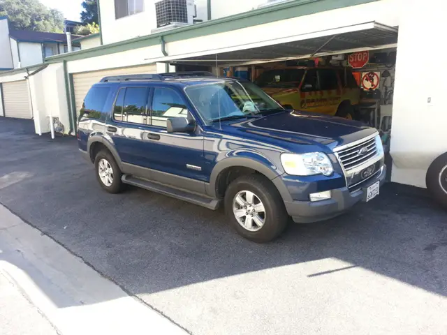

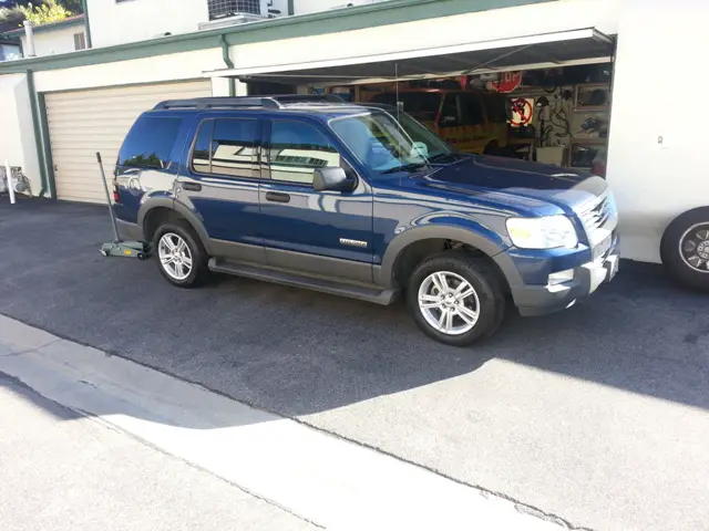

After just a little over 2 years of having this truck the Dunlops, which were New went bad...and I mean really bad!!:( They are dated made in 2010, but have cracks all through the tread, and 2 of the 4 have come a part inside and started to bubble on the tread. This has made the truck pull to the right horribly, and I'm pretty sure took out the rack and pinion. In fact I was replacing the R&P when I came across the real issue.
Which leads us to today.. With the tires out of commission, truck wasn't going any where till I replaced them. Since I don't have $600-$800 for tires, I turned to craigslist. I was looking for take offs as I could buy them cheap, and then sell my current wheels. This is what I found.;)
2012 Ford Mustang V6 17" Wheels. With 215/65/17 Michillens that were on the Mustang for 3 months for Under $400:thumbsup:
Bolted right on, no issues. Only thing I have to do is pull the sensors from my old wheels and install them on these new ones. Tires are about 1/2" sorter but will work for now.
Enjoy!:D

Looks really good with those wheels on there. Like you said, have to fill up the wheel well.
I am also impressed at how you were able to feng shui JP into the garage. :p:
Nice! Now what I really want to know is how did you get JP into the garage?
With a Dino squeezer of course! And he closes his eyes while backing in! Lol

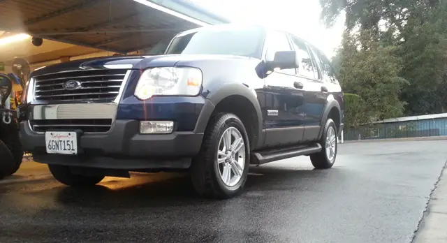

I couldn't help washing it last night after I test drove it.:afro:

Thanks for the info. The Ex looks really good.
So are you lowering the ex? i know its hypocritical for me to say this, but thats a big fender well gap
yeah it does look a little funny, but being broke and needing tires this was the cheapest route. They are 1" smaller then stock. It will stay like this till we get rid of it or I replace the tires again, which should have way more availability with 17's. If that happens I'll probably go to a 235 or 245;) Should also pick up some MPG with these too
It does prove that Mustang rims are a direct bolt on option for us 4th gen guys:thumbsup:
Just means less rub when you flex the suspension on the trails! Or, you know, speed bumps and curbs :D
The wheels look good, as does the rest of the Explorer. How's the ride, handling, noise, etc. of the included tires compared to the old tires?
even at 40psi (max of 44psi) the new tires ride like glass! Very smooth. New tires are Michelin Energy Saver All Seasons. I didn't really care for the Dunlops that we're on there.
With a smaller tire with low rolling resistant, it defiantly feels peppier. In fact we joke that it thinks it's a Mustang now, because it have the motor and the wheels from one now..lol
