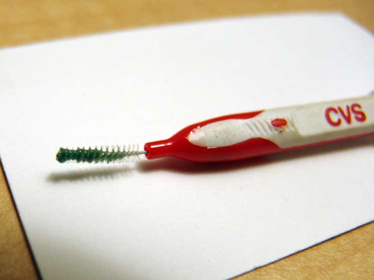

Thought I found the problem when I used more Caig DeoxIT in the female connector by the battery:
After finding that goop, I just knew I nailed it. Jumped in the truck to drive around the block and watch the light go off... Never went off!
