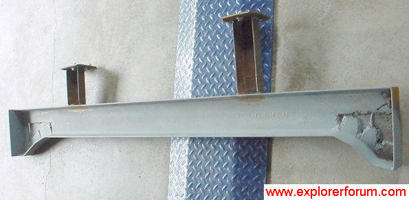

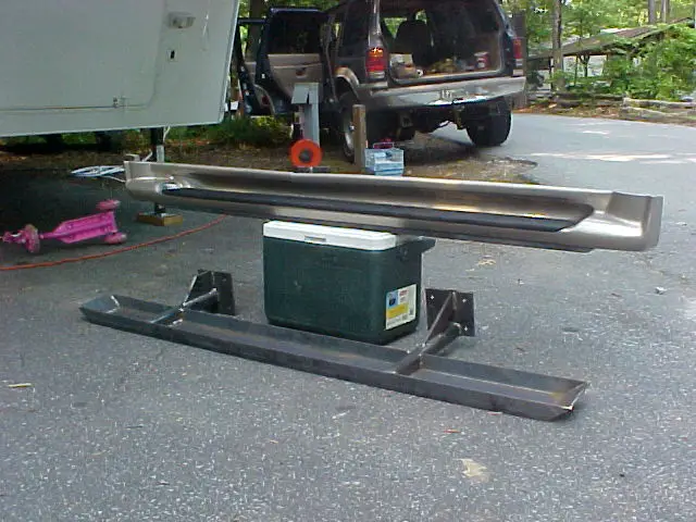

Rocksliders done the "Herc" way :bounce:
I?ve grown a little weary of buying new $$$ running boards every time this occurs
so before I install my next set I've decided to beef them up a tad :D
That's 2"x 6" channel steel sliders on frame-mounted 1 1/2" x 3/8" walled square outriggers, folks, as heavy-duty as a tank; and once installed you will barely be able to tell that they are on there. The running boards lay perfectly onto them and if you look closely at the one on top with the running board laying on it, you will see that less than an inch peeks out under it. They are nearly invisible, I will lose almost no ground clearance at all, and I will still be driving a "sleeper" on the trail.
:D Can you say BulletProof? :smoke:

That's looking good! Did you use exsisting holes in the frame or are you gonna have to drill new ones?
Thanks guys. Yes Ray I will be drilling new holes in the frame :( I'll be buying a couple of extra drill bits, I suppose. This week I will drill a couple of 1/4" drain holes in the sliders and then prime and paint them.
I am going to try to install them next weekend; of course I will have to drop the fuel tank and possibly move the fuel lines and stuff that are inside the left framerail for the left one, so I have no idea how big of a job this will be. These suckers are heavy, BTW.
Pink Trike ??
Okay Gerald - -
What is up with the pink trike scooter ??

Hey, that's the custom fold-down model, an essential item in my trailkit to get me out in case of breakdown on the trail. :D

those sliders look good! did you make them or have someone do it? i think they will look really good in their "hidden" form.

I had them made. I am not nearly a good enough welder to do this job.
Chris, I missed your thread. Looks like we have similar ideas. I noted the responses on your thread questioning the two frame mounts. That's worried me a bit too but I am going to give these a go and if they flex too much or look like they will flex the frame I am going to put a third outrigger on each side or gusset them against the body.

Hey Gerrald, I dont know how those sliders fit with the factory side skirts (I mean how tight, clearance) so I would be worried about water/mud/sand getting in there and staying. I see you already plan some 1/4"drain holes which will help, but I would also suggest (ready for this) using a coat of, (yup, you guessed it) Herculiner (wear pants and gloves, pee before you start for the sake of the 4x4ing world) just to be sure. It would be a real shame to go through all this just to find in a year from now the sliders are rusting out from some stupid stubborn water that wont come out......
I just got done hacking about 4" of metal from my rear quarter (dont know if you saw my rust in Moab) because the previous rust repair (before the blue paint) wasnt done right. It took all of 6 months for that rust to expand about 4" x 6", I was hoping to be able to save some metal but after all was said and done I am now missing a rather large chunk from in front of the rear tire......I will be herculining everything that gets rock chipped (about the bottom 4-6" of the body) all the way around after the repair is complete.....
Maybe run a bead of silicoln between the sliders and the factory rockers too?? to help keep the nasty's out....

Best bet is to copy the design and just have a local fab shop or friend build them for you. :)
Yes, you'll need to get a local to do it right. Mine was made by a local welder. We took measurements of my vehicle and he made them to fit it exactly. For example, clearance from my left frame rail out to the body is about 3/4" diferent from the length of the clearance on the right side. I did use simple 2" x 6" channel steel for the sliders which fit perfectly within the Eddie Bauer running boards, but the outrigger connectors to the frame really needs to be done on an individual basis according to your specific vehicle, if you want it to fit perfectly.
