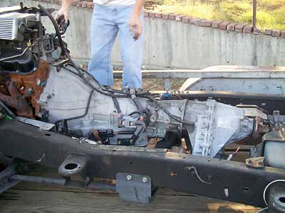

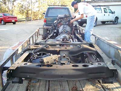

Well I went and picked up my donor truck chassis today. It was the first time I saw it in person. The reason the chassis is a chassis and not an Explorer is because it was an insurance fraud truck (I guess you would say). Whoever bought it back in '99 decided they didn't want to make payments anymore so they set the interior on fire. Nice huh? Well, the guy assured me that although some stuff in the engine compartment was on fire, the engine was still in great condition. As I drove into his driveway I saw the front of the chassis (mainly the fan) and was a little worried.
So I got it home and decided to tear into it a little. The guy was right. The fuel rails, fan, altinator, and a few harnesses are the only things that were really damaged. I checked under the valve covers and the engine is perfect. Looks brand new (which is basically is). So my Dad and I are fairly certain after some minor rebuilding, this 5.0 should rock. Here are a couple photos to hold you guys over till I get some wheels and tires on it (so I can get the damn thing off the trailer).

Since it looks like your 1999 wiring got toasted, You'll need to swap all the wiring off your 1996 frame to the 1999 frame. You'll also want to change to Return Style fuel system. You should be able to get evrtying needed to replace burnt parts off of your 1996 5.0

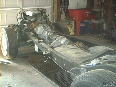

I pulled off the intake, valve covers, and manifold on the new 5.0. Everything looks sweet. I just need to do a little cleaning. The injectors even looked good although one of the connectors was a tad bit melted. All in all I think this is going to be a smoooth runnin motor. As long as I can figure out this EGR thing. The oil filter is also in a different place than my 5.0s.
Is there anything I can be doing while reasembling that'll increase power? I know a cam would and stuff.. but I mean larger injectors or anything?
I finally got the old melted fan off tonight. When I put a new one on I think I'll use the right tools for the job. :D But it's off now.
Right now I am waiting for some answers before I can move foward.
I need to solve the whole EGR dilema. I've posted some messages on a few Mustang forums and I'm waiting for some answers. I might have to get some GT-40 heads to put on the '99 engine.
Once I figure that out, I just need to gasket and reasemble!
I need to make sure the tranny will plug right into my harness.
Then I can lift the body, swap the fuel system, switches chassis, bolt her down, load on the 32's and go! :D (In theory)
