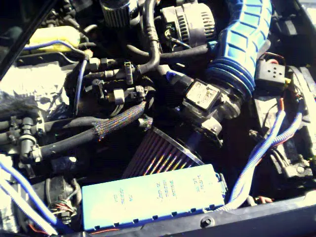

ok check this out! I wanted a "cold air intake" now i have it, for hundreds less. i bought a K&N cone filter from advance auto parts. then i went to lowes and shopped in the pluming and electrical depts.
K&N filter: 30$
Flat PVC bushing 1.99$
Lightswitch plate(dual switch): .97c
Orange gasket sealer: 1.99$
2"-3" rubber PVC bushing 3.00$
Nuts& Bolts (1/4x28) metric from adv auto parts 4.00$
TOTAL = 41.95$
Frustration of making it work right? PRICELESS
i will try to get some pics up on my site soon but thats what it cost me. UNDER 50$!!!!!:eek:
i used the flat bushing and the lightswitch plate to make the ever popular "adapter" and the 2"-3" rubber PVC bushing was used to fir to the filter. the lightswitch plate was "modified" by the power of my dremel™ tool. i drilled 4 holes in it to make it bolt to the MAF, then i cut a hole out of the middle to match the opening of the MAF. the PVC flat bushging was epoxied to the light switch plate. it took me about 3 hrs to set it all up, and that includes smoke and soda breaks. i used my stock intake plenum. as a side note i would cut the PVC flat bushing in half to make everything fit a little bit smoother.

yeah, it worked nicely however the 2-3" rubber bushing was not nessecary after all, i used the PVC flat bushing and cut it shorter on both ends, fits puuuuuuurrrrrrrfect now. i will have pics tomorrow sometime, they will be posted on my website.

true...I look at this setup like this...it took me a while to put it all together, and it works. i promise it does not look like S*(& however for those having an extra 2 or 3 hundred to throw around. go for it. i mean you cant just slap this together, it took some painting as well...
all i can show u is a pic where its installed..and use MS paint to make a few arrows to the lowes parts...

UPDATE NEW PICS OF INTAKE UPLOADED
NEW PICS CLICK HERE
the link is for my site, but since i cant figure out how to post individual pics on here( can u tell me how?) you'll have to visit my website pics are at bottom of page...
Send me the pics and I can host them for you on a site with more than 1 meg bandwidth or whatever Geocities has. You've already hit your transfer limit on there.
i'll need your e mail addy to do it...
pics e mailed...just go ahead and post em when u get em. thanks ahead of time for posting them for me...

I guess I didn't read correctly, I thought you redid the whole system, not just build an adapter. Here's what I did with mine:
no i cant find something ilike to re do the intake plenum tube...know of anything that works on a 94? i was thinking going to a muffler shop and having some pipe bent but metal absorbs heat, i dont need any more hot air comming in....
