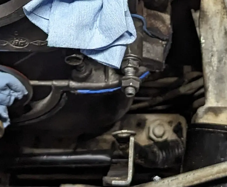

Finally got the Mounty back on the road tonight! The headers definitely perked things up, but I am beyond ready to yank out that sluggish 4 speed auto.
A couple things I need to resolve in the shorter term:
As for the lean code, what are some top places to look? Keeping in mind I just replaced all the engine gaskets that is. I'm trying to think of what could be letting unmetered air in on just bank 2 and all that comes to mind is the lower intake gasket. I thought I had everything lined up nicely as I used dowels to guide the manifold onto the heads, but maybe I screwed something up still. Could it also be a failing O2 sensor? I did accidentally strain the wires on one of them while pulling the downpipes back for the header install not sure if that could have increased the resistance of the sensor (I also don't know whether increased resistance would read lean or rich).
- The P0174 code, bank 2 lean, has returned (although bank 1 lean code has not)
- My hood latch won't release
