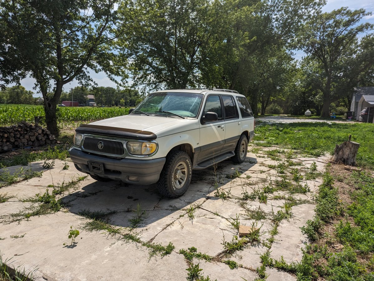

I finally got a 302 donor for my '00 Sport!
Before I start hacking away though, I had some thoughts go through my head:
1. AWD really does handle nice on gravel country roads.
2. There's a lot I want to replace on this 302 that I could do before I pull it out of the Mounty.
3. Although the body has rust, the frame and suspension are very solid.

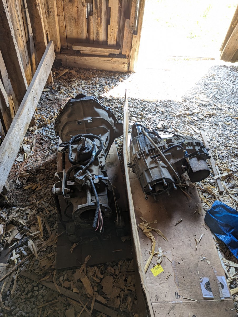

4. If I wanted, I could use the Mounty as a proving ground for my manual swap -- I happen to have a M5R2/BW4406 setup just laying in my barn...you can see where this is going.
After explaining these half-baked musings to my wife, she responded "as long you make building my chicken coop a priority." So it looks like we're manual swapping a Mounty!!! As soon I I get a chicken coop built anyway haha
So here's to my new best bad idea; it's dirty, it's leaky, it's going to be a ton of fun!

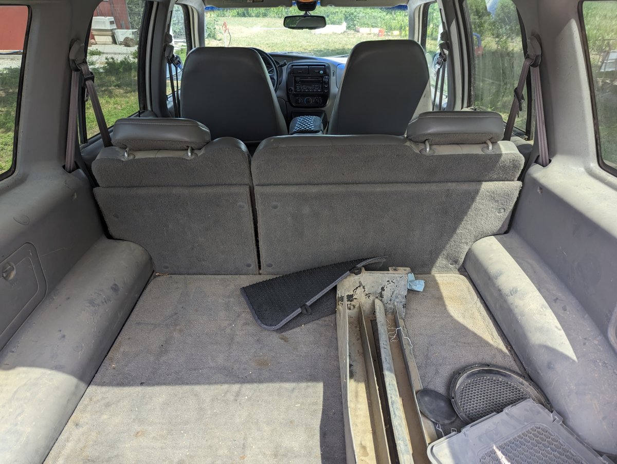

Fold down those back seats and be amazed by all the cargo room.

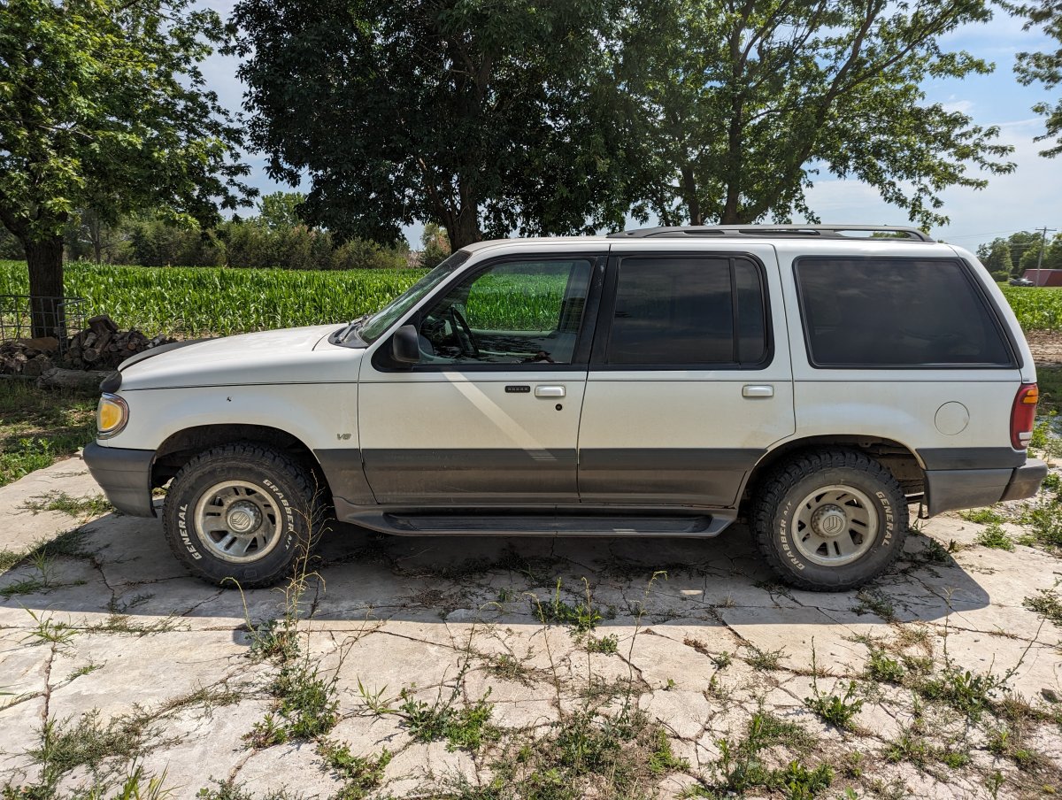

I'm gonna say I bet you'll like 4 doors better.
I love my 2 door for what it is (kinda sporty, kinda unique), but yes, I'm happy to have another 4 door back in the fleet!

Gotta get these bad boys moved out of my old barn so I can tear it down for chicken coop materials!
