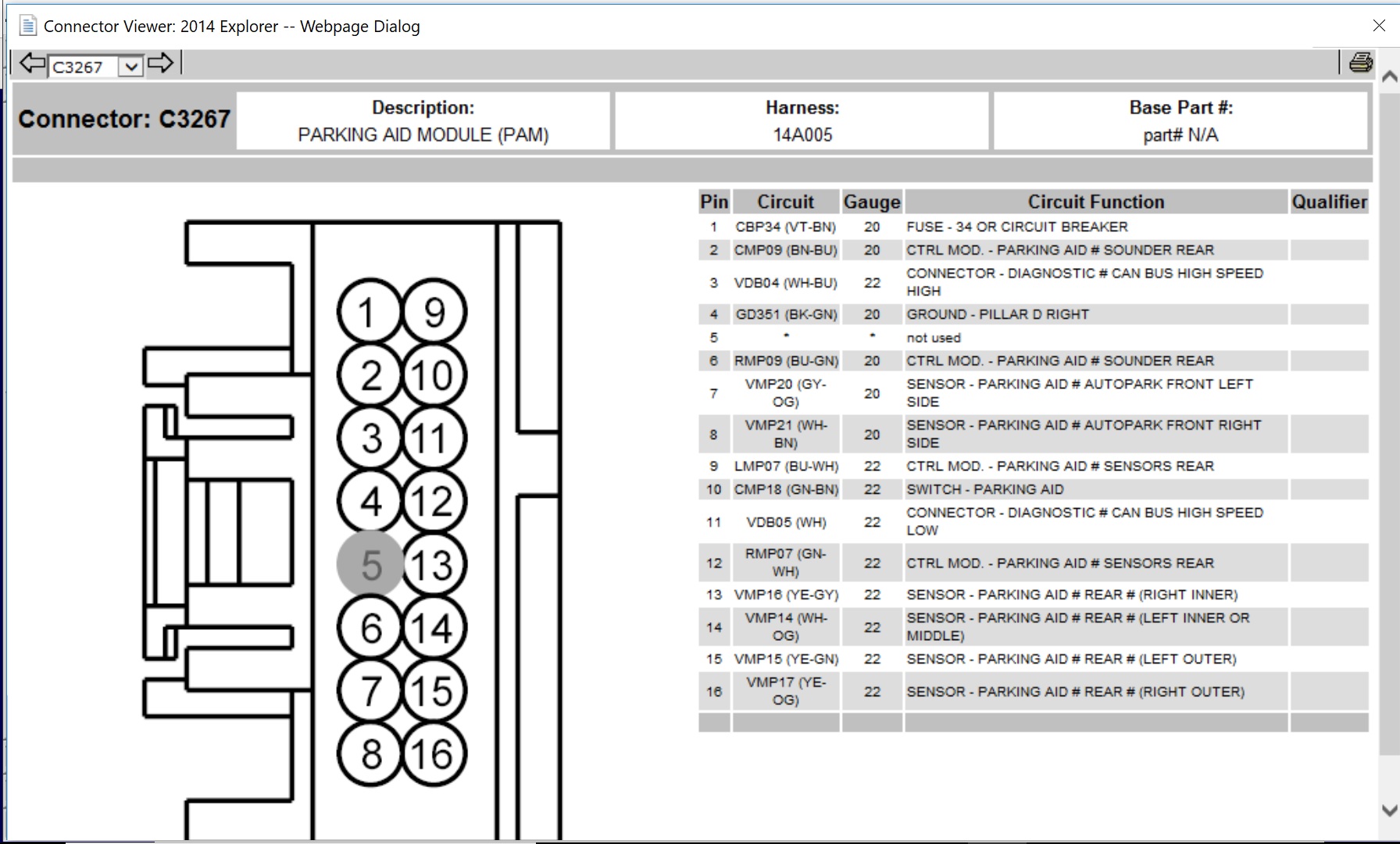

Where is the rear parking sensor module located on my 2013 Explorer Sport ?
I have to convert the electrical connector of the tow hook from 7-pin "US" to 13-Pin "EU/European Union" configuration ..
The conversion kit I have says to cut the ground wire of the rear parking module.
Where is it located ?

Found the PAM (C3267) location:
it's behind the right side panel, below the rear quarter window.
Thanks, Peter, ... the url of the pic you posted lead me to the pic below. ;)

I have the 2014 manual, but this should be fairly similar. Here's how to access the Parking Aid Module (.pdf) and the wiring of its connector (looks like ground is terminal no. 4):
I'm still confused as to why converting the connector requires messing with the Parking Aid system.
I also attached the wiring of the Trailer Tow Connector for good measure...
