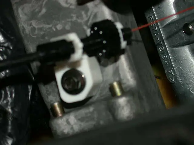

The first (out of focus) shows the broken piece next to the wheel.

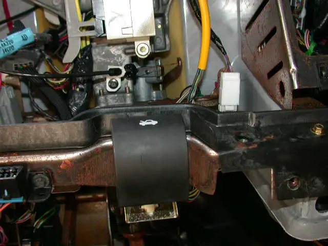

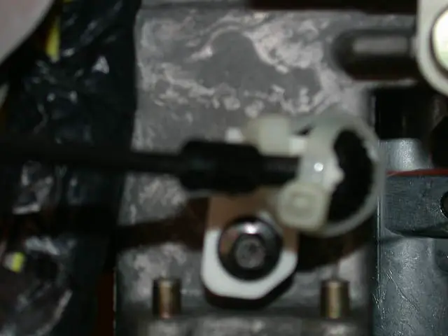

The second picture (out of focus) shows the cable tie fix. The last pic. shows the view up from the floor (before the fix.
