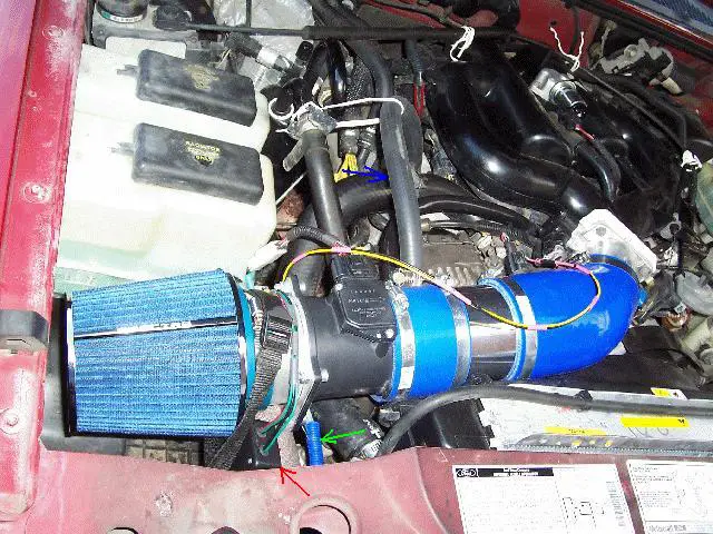

When I replaced my stock MAF sensor with a Lightning 90mm MAF sensor I also converted to a matching 4 inch diameter main intake tube and Spectre cone air filter.
I was concerned about the cone filter drawing warm air from the engine compartment unlike the stock filter that draws air from an opening behind the headlight. This morning I performed a data log to determine the impact.
The engine was cold started with an ambient air temperature of 74 degrees and the same intake air temperature (IAT). By the time I had backed out of the driveway a minute later the IAT had already increased to 78 degrees. I noticed from the data log that once the engine was fully warmed up the IAT would drop to about 3 degrees above ambient after driving above 35 mph for about 70 seconds. I also noticed that when stopped at a traffic light the IAT would steadily increase to 100 degrees in about 75 seconds.
There is a general consensus that for temperatures above 70 degrees, fuel economy and engine performance improves with a lower IAT. Since most of my driving is in the city I intend to revert to a dropin air filter. Especially since I have two 1.75 inch diameter cold air intake tubes coming into the bottom of the stock air filter enclosure. But first I will have to modify the stock enclosure top to accomodate a 4 inch diameter main tube. I will purchase an Amsoil filter element since tests show it to have high filtration with low restriction.
