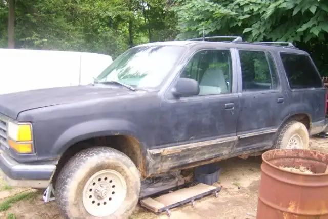

Just picked up this Exploder last week. Its not in the best of shape but overall its decent. The motor runs great and the body has very few dents and dings.
When I got it the trans was out like every other a4ld. I am a 5 speed guy myself and was planning to convert to 5 speed anyway.

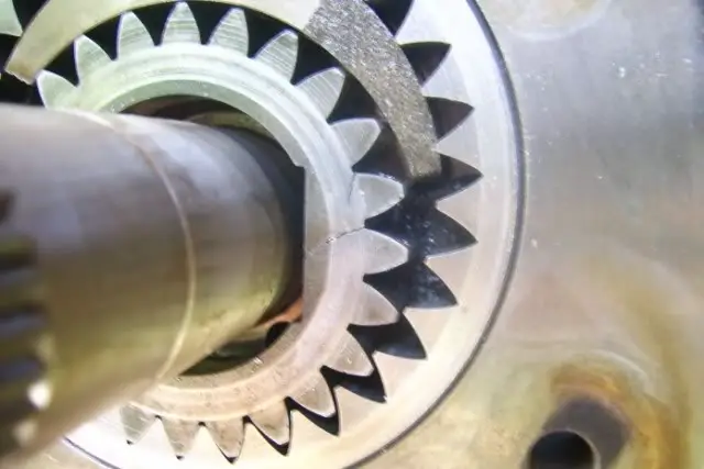

First thing and did is check the fluid in the trans. Nice and red, full, and doesnt smell burnt. Pulled one of the lines at the radiator and fired it up and no fliud. Nothing at all. Pulled the pressure plug in the side of the trans and fired it up to make sure the lines were not stopped up somewhere and still nothing so I knew something wasnt right with the pump.
Got it home and put it on some jack stands and started tearing out the trans.
Got the trans out and pulled the torque converter out and found some scaring on the snout. Thats not supposed to be like that. lol
Pulled the bellhousing off then the pump from the bellhousing and theres the problem. One of the pump gears cracked and spread the teeth apart and locked up and spun on the torque converter.
Oh well time to throw it in the scrap pile. Dont want to spend the money on it again not even know if the rest of the trans is good and for it to just break again. I figured I could swap in a 5 speed for not much more then fixing the a4ld.
Figured I would mess with the inside a little while I try to find a trans.

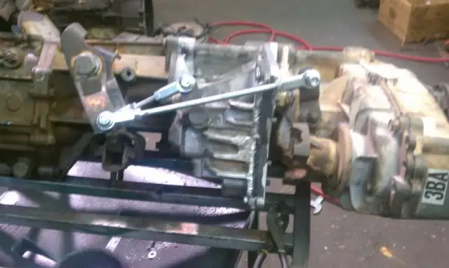

Since I am such a noob, what's the deal with the crossmember? Was there something there before, and what function does it serve?
it's there to support the tcase.
It holds the transmission and transfer cases up and in place. I had to redo it cause the stock crossmember was in the way of the front driveshaft so I had to go up and over it to clear it.
I see. It looks good! ;)

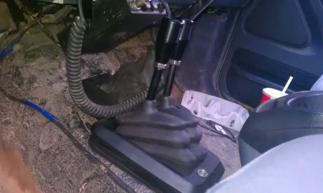

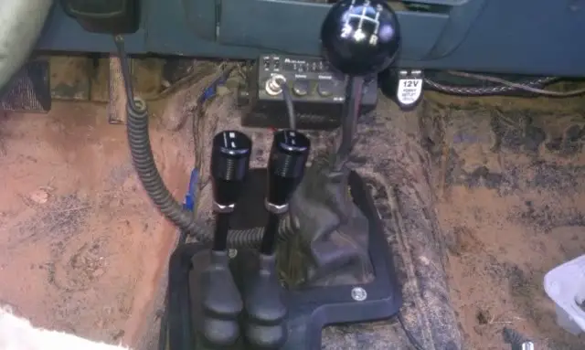

Got my shifter knobs for the doubler today so pulled the shifters out and cut them down and threaded the ends for the knobs.
Got a trip planned to Mountain City, TN next weekend to test it out finally. Going to try to get some new rock sliders put on this weekend.
The shifters look too good for that muddy floor! ha

I like the double transfer case.:thumbsup:
