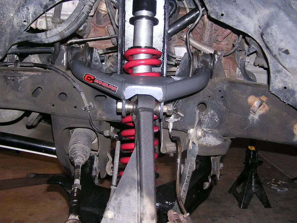

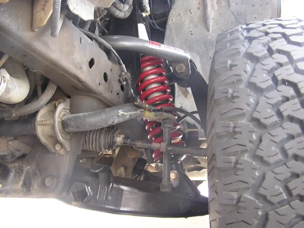

Actually kinda took two steps forward & one step back last night, the 650 lb. springs are in and WAY thicker coils than I had anticipated, and my dumbarse had the uppers in the middle of camber adjustment while setting up...long story short, the shock tabs on the lower arm were cut off & new ones put on about an inch more inboard toward the frame. It has very little clearance at full droop with the camber adjusted all the way negative (in the real world, I doubt you'll ever need it that way, but I redid it for the worst case scenario.) full droop, there is MAYBE 1/4" from the coil to the frame and from the coil to the uniball cup...2.5's are an impossibility without hacking the bejesus out of the framerails. I should have the driver side complete tonight, though, and will post pics.

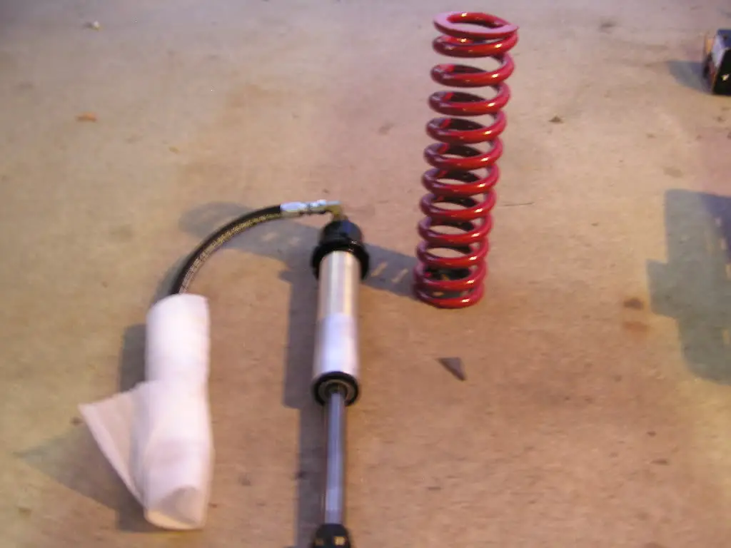

ok so as brandon stated in the last post there was a little hiccup on the lower shock tab as far as placement..now that it's all figured out the driver's side is almost(!crosses fingers!) done...the coilover shocks and springs are both here and man are they beefy...what the heck is this a trophy truck?! 7/8" shaft diameter and the springs are damn near 3/4" thick(eibach 1400.250.650) i'll let these two pictures talk for the time being..enjoy!

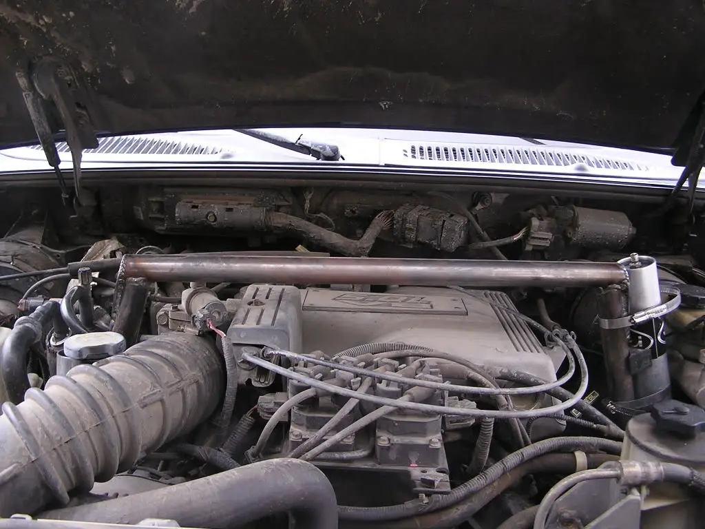

engine crossbar and upper shock mount bosses just finished up last night...then tonight all that needs to be done is the final mounting of the shocks, resivoirs, tires, etc. and then we'll cruise it around the block for alignment purposes and finally set the ride height...pictures to follow late tonight...and then we're DONE!!!
haha...he left my house late last night at about 10:00 or so. the 650 lb. springs are marginal for the ride height we wanted, but I believe that is the heaviest spring Eibach makes in a 14" length.
It rides decent & everything, but if it actually bottoms out metal to metal, there will be coil bind. I told him to put a couple zip-ties on the coils & go beat on it & see if they get pinched off/dinged. If they do, we will need to find a heavier coil from somewhere.
