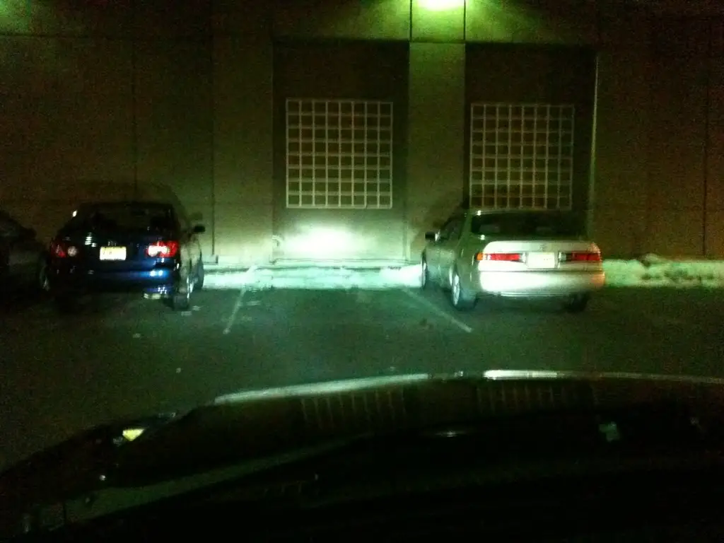

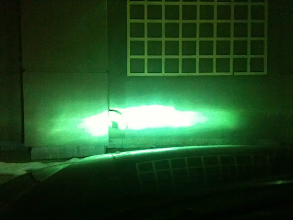

These were my HORRIBLE 6000k eBay HIDs, in my CCFL Halo Projectors:
Just my 10,000k fogs:
6000k eBay HIDs before aiming:
Both
The pictures really define the glares mine had for some reason. It wasnt so choppy in person. Now I have a set of 5000k Retro-Solutions Digital HIDs, and its amazing. They still need to be aimed, which I need to figure out how, but its so much better over the eBay kit.

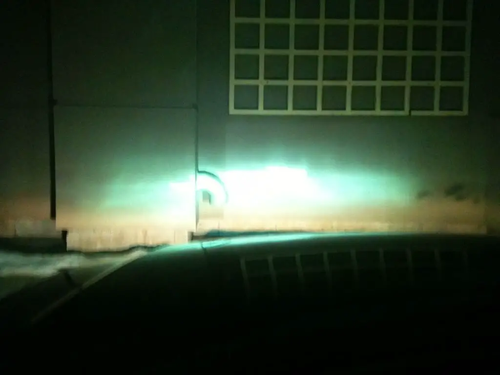

Here's mine, 6000k hids in the aftermarket clear housings...sorry for the terrible iPhone quality pics lol
NOTE my passenger side headlight is terribly misaligned because the alignment adjuster thing is broken, so it's pretty much aimed where it wants to be right now haha
just lows:
lows and stock halogen fogs:
lows and fogs, backed up a bit:
