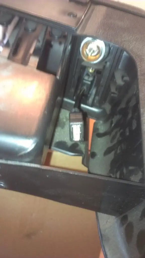

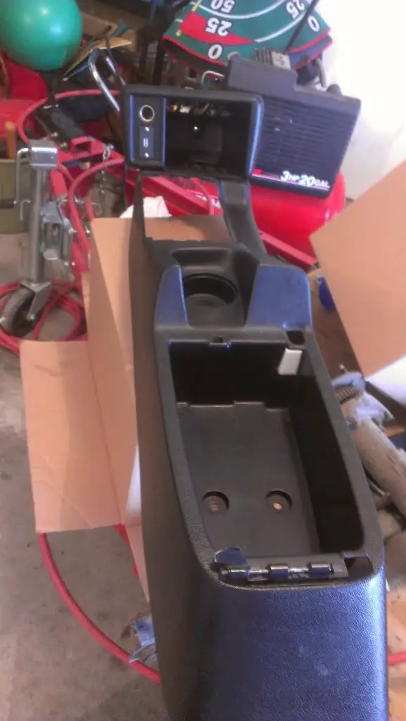

I tapped into the rear seat's 12V outlet in the center console. Yes those are quick disconnet T-Taps. I bought them years ago, and found them just before i did this, luck as it were, I want many more, they are so clean. see the OP for removal instructions. I just snaked the wire fron the opening under the dash to the 12v wires.
I got this on ebay for 10 bucks, 4 ports. It had an led installed that lit the blue ring up half way, my diagnal cutters removed it. The top has flaps for a clean look. the back outlets are open to the air. it's very clean looking. I bought a few small 1A USB Car Chargers, $1.75 ea on ebay. Here is the finished look
ordering the usb ports later when i have some time to figure out where i want to put them. maybe at the front of the console under the HVAC controls.
