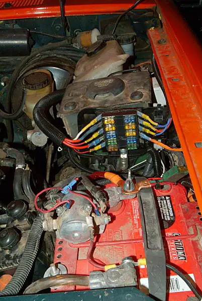

Next up is my new auxilary fuse box. All of those wires were running to the battery terminal and it was a mess. I need to be able to disconnect my batteries from the trucks electrical system quickly in order to use my 24V Readywelder. Once I add my marine connector setup it will be a real simple operation. I plan on making a cover for the new fuse box.

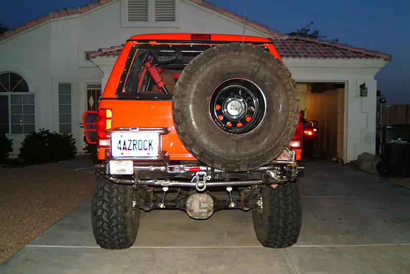

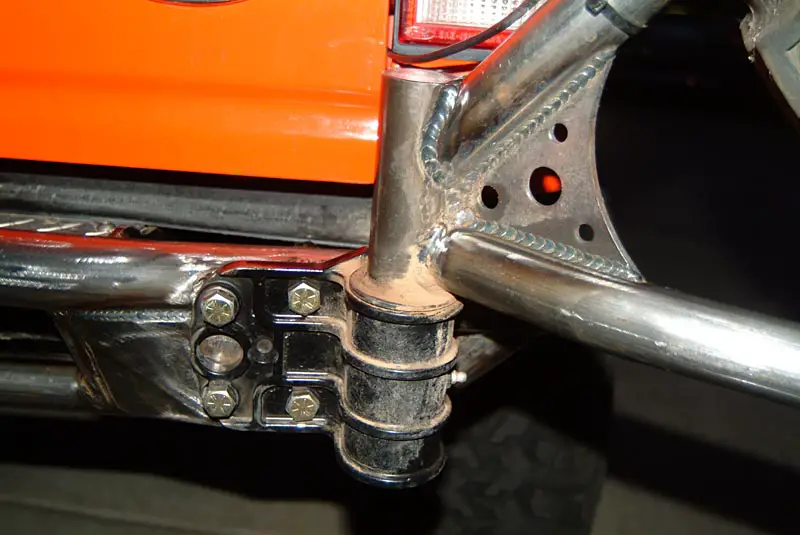

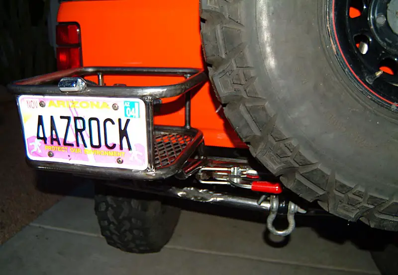

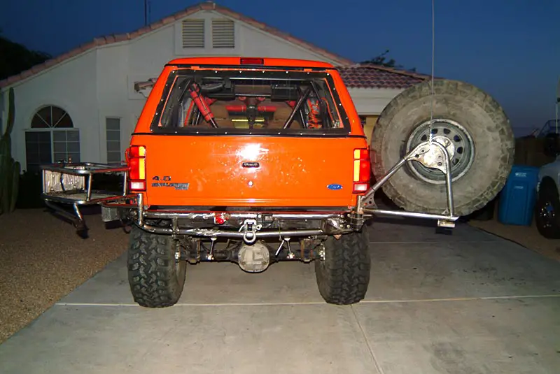

Last, but not least is a new rear bumper. I didn't like having to screw the wingnuts on and off with the old bumper. This new one has a latch on the fuel can carrier and a pull pin on the spare tire carrier. FST was trying out a couple different setups. The hinge for the tire carrier is off of a H2 Hummer. The black part of the hinge was about 5lbs on it's own :eek:
Now that is some welding!!! One again the Pumpkin does not disappoint :thumbsup:
Rick, where did you get that aux fuse box? I'm looking to do something similar with my wires.
I found it at a shop in Phoenix called "The Lighthouse". I don't have a number for them handy. They have them available in larger and smaller configurations too.
Damn, that's some beautiful welding in that last pic!
Do I see some rock rash on the new bumper???
Rick, I always wondered why you didn't wrap your bumper around. I like that. I found some of those latches, but the best hinge I have found is a Rockstomper Trailer spindle. Anyway, heres my bumper:Mine

Kirby, I felt if I started by wrapping the bumper I would eventually want to do an exo cage. I just started thinking about connecting one thing to another... So to keep from doing that I just left the sides bare:D

PAINT THE BUMPER!

Rig looks good, you can use a stock Explorer fuse block in the same fashion, it also gives you 4 more ports for relays. :)
I have my ARB relay in the stock box, also my roof lights, and soon to be trans cooler fan relay will be in there. When I run out of space I will add another Ford power dist box, they are really a great design and weatherproof. Also very easy to remove and open up.
