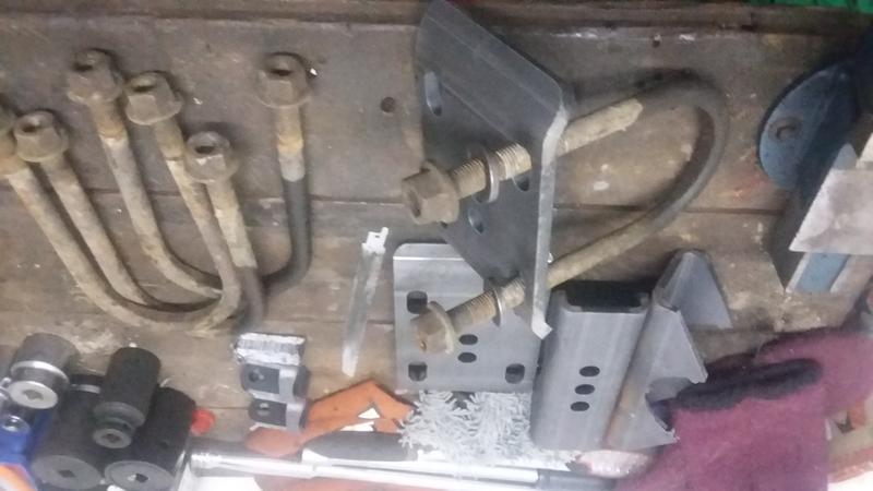

Got a set of U bolts from a dana 70 that fit Nice.
Looks like this could work :D

If those are used U-bolts use them for mock up and then have new made for regular use. I don't trust used U-bolts because if they are over-tightened, then are stretched and the integrity is compromised. There has got to be a spring, U-bolt shop locally.
