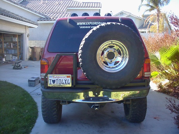

Rear is homemade (addiction now taking over), 1/8" plate, 4x4x1/8" box tube for air reservoir (that I don't use).
Tire carrier was removed because I'm going to pull the bumper to rework it a little when it gets warm. ;)
As it is now (the addiction won, I'm forever lost).

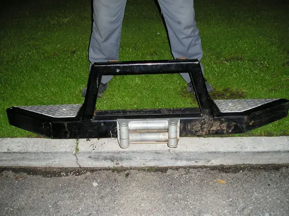

My new front bumper....Not on the truck yet :rolleyes: Also there will be some more mods to it.

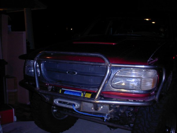

2 inch 0.188wall

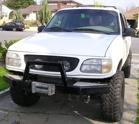

That front bumper is for a Cherokee XJ from Protofab. Made a few modifications, like cutting off the front 6" off the frame. Also had to put a plate across the end of the frame, then add tabs to that, since the Cherokee mounts are a few inches wider. Ended up cutting off the original bumper mounting tabs to get the bumper in a few more inches. Added shackle mounts and the light bar also.
Rear bumper is custom made from a 7X7", 1/4" thick beam.
Mudho-very sweet front bumper man. This is pretty damn close to what I am contemplating to do to my rig. My **** is too weak right now to take a hard hit or do much more than being for looks and a hi-lift point, but that is nice and beefy. I think I would make it dual-tube, and bending up on the ends to meet the other tube, similar to my rear bumper, just to make things a bit beefier on the rock-bashing stuff, and for sliding off the rocks.(but it looks really nice!! just need to toss a winch in there!! :thumbsup: )
