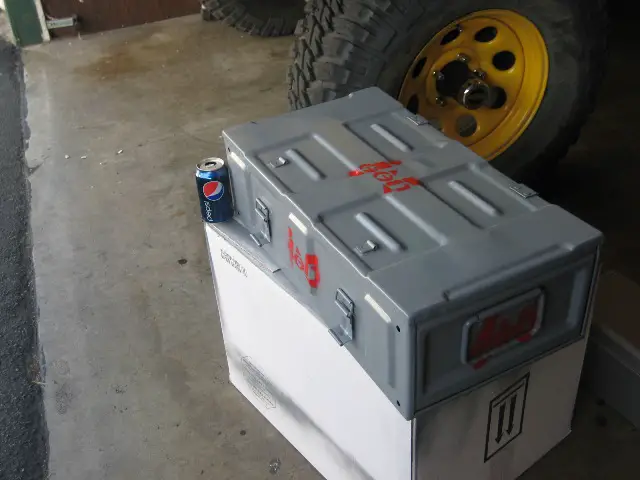

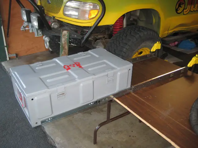

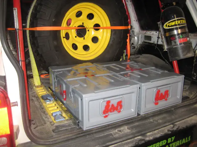

So currently I have my e-track in the truck which works great, but I want to get a little more organized. With this comes storage boxes. I have used different large boxes in the past, and seen various wooded ones made. These have two issues. 1. They fall apart over time. 2. they can be a pain to get in and out of. So the answer is steel boxes. I'm getting a set of these 81mm ammo can, which are pretty rare these days...

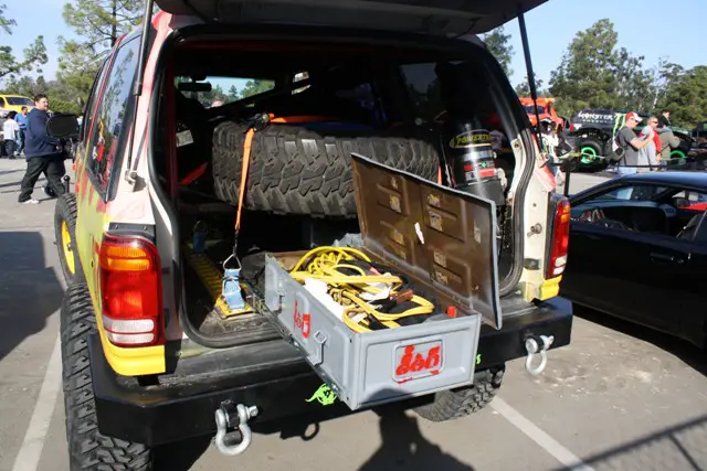

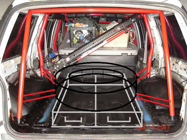

I will mount the side by side in the cargo area, on some sort of sliding rail system to make easy access to tools and supply's. I'll then add to the cage by making a cross piece to support the 37" spare over these boxes.
