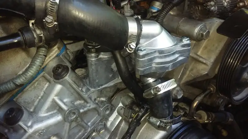

I can't emphasize enough to use either the Motorcraft upgrade parts or the aftermarket metal housing. I've been thru the Dorman/Four Seasons junk and you'll most likely end up re-doing the job in the near future (my Four Seasons housing lasted all of 10 days).
If you can do this job by not removing the upper intake, more power to you. I simply don't know how it's feasible on my '98. That t-stat housing needs to be lifted and lowered more or less straight up and down to avoid breaking off one of the three plastic tabs on the bottom of it (they can fall into the engine). And, the Crank Pos Sensor wiring runs fairly snug across the top of the housing on mine...so, it needs some slack to lift the housing. This can only be done by removing the alternator, alternator mtg bracket and tensioner to free it from two clips on the front of the block. Then, there is that p.i.t.a. short hose that connects the housing to the water pump. With the upper intake removed, it makes this job much easier IMO...plus, it gives you the opportunity to replace the upper and lower intake gaskets which are probably needed, anyway.
