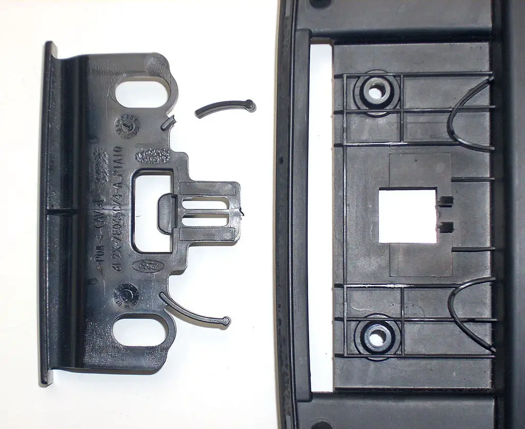

Anybody have any insite on fixing the broken latch problem on the console cover other than spending a $100 to buy a new cover?

In the picture on the right (latch slide) the broken piece is the bowed curved arm in the lower LH corner. Does anyone have an idea on how to mend the plastic arm? The problem is the arm acts as a spring forcing the latch forward to lock the lid down. I've super glued it but the bond is not strong enough to handle the side force of the spring action. Without repairing the the arm on the latch the alternative is replacing the whole lid.
There is a number cast into the plastic, couldn't read it on your photo. Post/send it and I'll see what Ford has to say, but it's not promising.........

sorry to bring back an old thread. but my 2007 xlt had this same problem. i got tired of fighting with it and decided to try and fix it yesterday. once i took the screws out and saw that one of the plastic spring arms was broke i called the dealership for a replacement but they wanted 130$ for the whole lid.
i decided to try and fix it myself, after thinking about trying to melt the piece back on i realized it will just brake again. as i was thinking of what to do i saw a mechanical pencil sitting on the table with a metal clip on it, i went and got my dremel and the latch, i used the dremel to cut into the latch maybe about an inch and a half. took the clip off the pencil and slightly bent it so it would act as a spring, put the clip into the slot on the latch and put super glue all around it just to make sure it stays in place.
after the glue dried i put it all back together and now it works perfectly, if you would like pics to show the finished result just let me know and i'll go take a couple.

I removed the second latch also and used instead two 30mm (1.18 inch) springs.
Just installed the armrest and it works better than new! :thumbsup:
Remove these two small plastic walls:
Removed:
Second latch removed and two springs added instead:
Nice solution! That looks FAR superior to what was there to begin with.
How did you secure them in place?
I was thinking about to secure them in place by srcewing a screw from the right side trough the plastic into the spring.
But it was not necessary. The springs are sitting with a little pressure, which is enough to secure them by themselves.
Just had luck to find the right springs at my first try! ;)

This fix is great, thanks for posting it! If you are looking for suitable springs, I went with these from McMaster-Carr and they worked perfectly:
9657K155 : Steel Compression Spring, Zinc-Plated 1 Spring-Tempered, 1.25" L,
.375" OD, .035" Wire, pack of 12 $6.58
