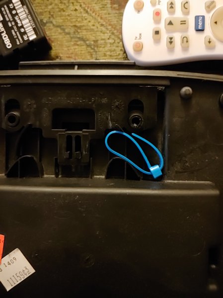

Know this is an old thread, but on mine, I took the MacGuyver route.
I took a zip tie (one of those foot long ones, that I had in my tool box for years) and zipped it into a loop (about the size of a half dollar) that fits into the area where the broken plastic tab was.
Nestle it in there and it'll want to stay round. Important trick is not to put a hard fold into it.
Once you've got the right fit, snip the excess off.
There is enough tension on it, that acts like a spring, putting the cover back on is all that is needed to keep it in place.
Worked like a charm for me, I only had one broken tab, but it should work even if both sides had failed.
I didn't think to take a pic, but if anyone is interested, I'll pull it back off and post some.
That sounds awesome. I might try this tomorrow. Thanks for the tip!
I took a pick, forgot I left a little tail on it for a bit more spring. The zip tie should be about the same width as the broken prong...
I took a pick, forgot I left a little tail on it for a bit more spring. The zip tie should be about the same width as the broken prong...View attachment 169347
I ended up fixing my center console lid latch using your zip tie method. It took me a few tries to get it to where I thought it was good but super easy. The side with the zip tie is a bit stiffer than the oem side. Contemplated on snapping off the remaining oem side to make it consistent pressure on both sides but couldn't bring myself to break it. At least it has a solid *click* when I close the lid now. Thanks again for the tip!
