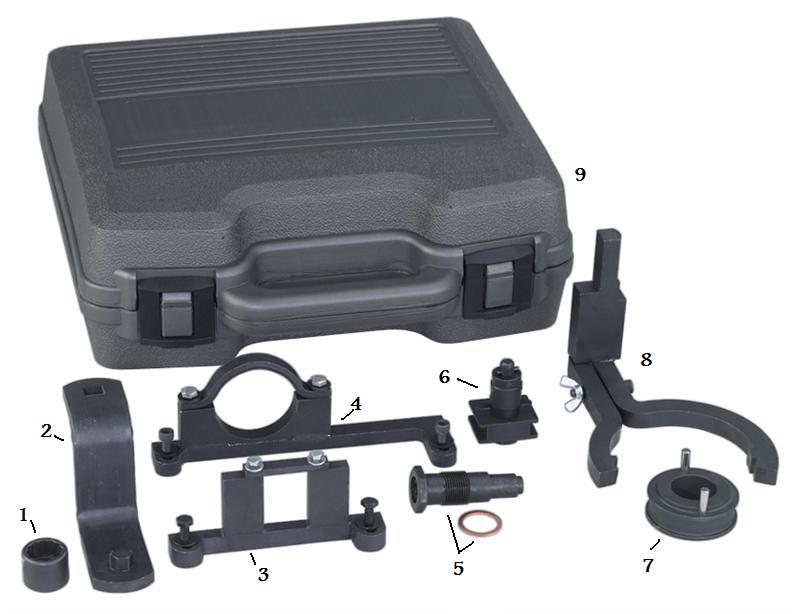

02 explorer was still running but timing chain rattling, rear cassette broken. pulled motor, changed all gears and chains using OTC cam tools. spun over several times, put back in. cranked, ran really rough a few seconds and died, great compression on 2,4, and 6. no compression on 1 3 and 5. Going to tear back down thursday. is it possible to have one cam 180 out, using the OTC tools, I thought they would only fit one way?
