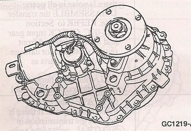

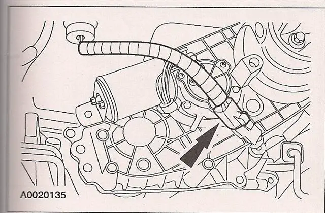

Here are a couple of pics of the transfer case shift motor from my shop manual. Hopefully it will help:
Thanks...I Will check it out early next week and see what I can find out by myself...Trying to stay away from the SHOP!
