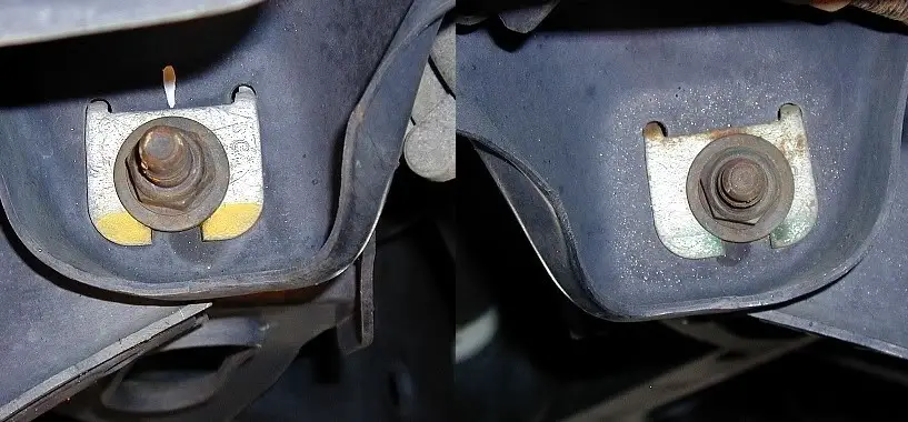

Okay, I think Im on to something.
I was looking for a reason why this wheel is leaning so bad and so far I think this is it.
They are adjustable per my Ford DVD.
And I found that the left metal keeper has the bolt on center (yellow).
The right one (green) is way off to the right which would throw the bottom of the wheel out. Factorys fault!:mad:
I also took some pics of the broke springs.
Those are the non-adjustable washers for the wheels... You can buy the adjusting kit which will let you adjust (I have the ingalls +-1 degree) them.

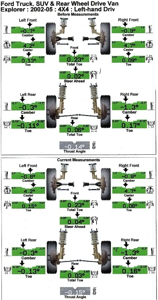

Well, I took it to a tire/alignment shop. And he hooked it up on one of those new 4 wheel computerized machines, and printed out this sheet and said it is in spec.
Bull sugar!:mad: No way. Is there any alignment guys here? Then I took it to my local Ford dealer and he agreed when he saw the sheet.
