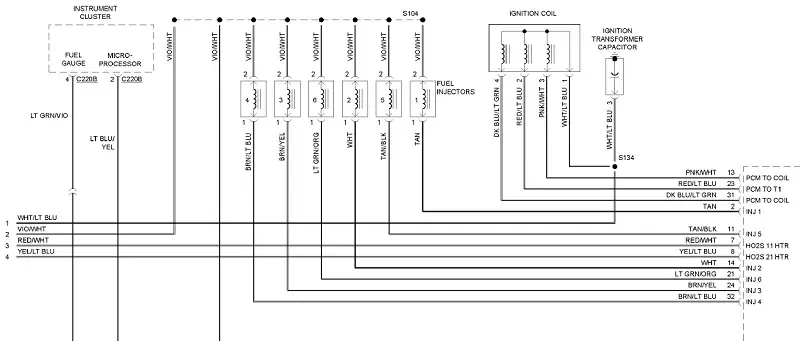

• The Fuel injector connections were tested with a NOID light. None of the injectors caused the NOID light to illuminate?
- The red line to the injectors is receiving a +12 vdc.
- The fuel injector control line does not seem to be grounding the injectors to supply the gas to the cylinders?

injectors not pulsing
There is a separate circuit for each injector to the PCM. I doubt that all of the PCM circuits would fail at the same time. The PCM computes the timing of the injector pulses based on the signal from the crankshaft position sensor. However, the PCM requires the camshaft position sensor signal to determine if a cylinder is on the compression or exhaust stroke. I suggest checking the connection to the camshaft position sensor.

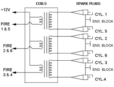

waste spark ignition

The camshaft position sensor has no effect on the ignition timing. Your vehicle has a waste spark ignition system. The spark plugs are paired. When one plug in the pair fires on the compression stroke the other plug in the pair fires on the exhaust stroke.
