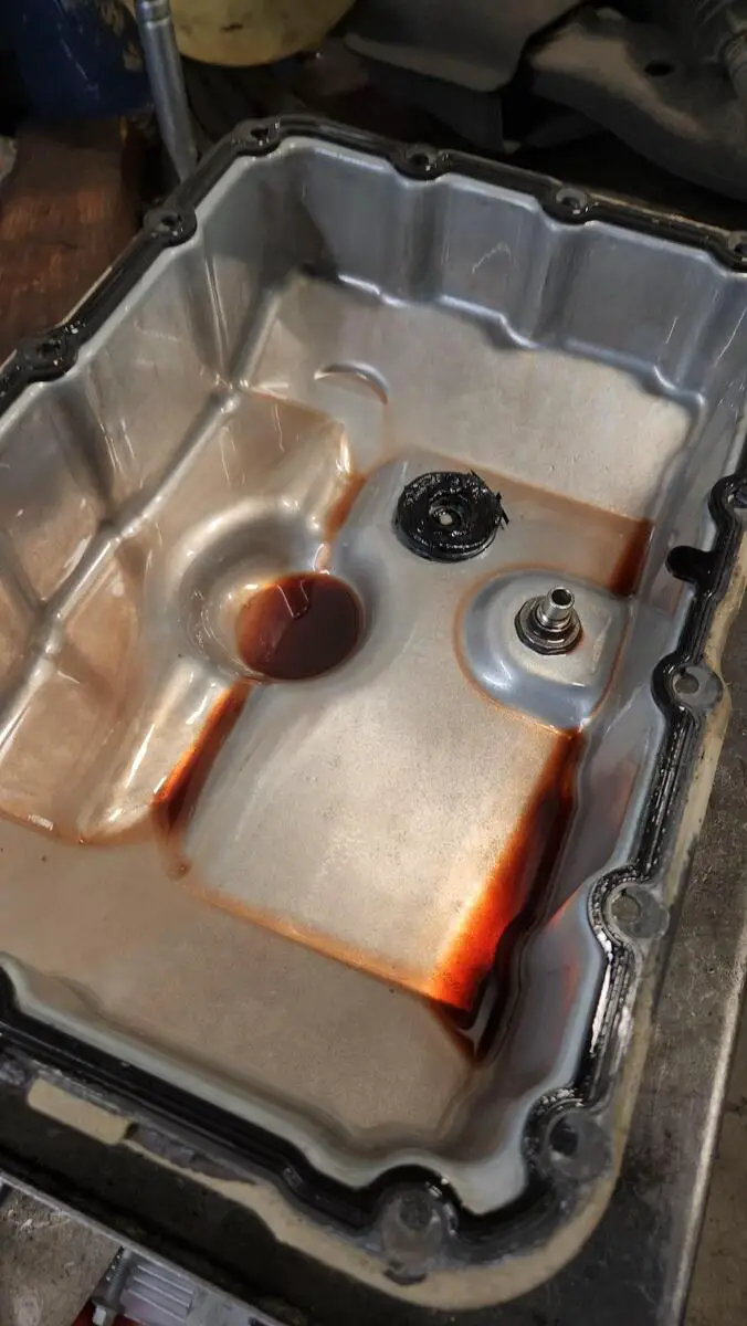

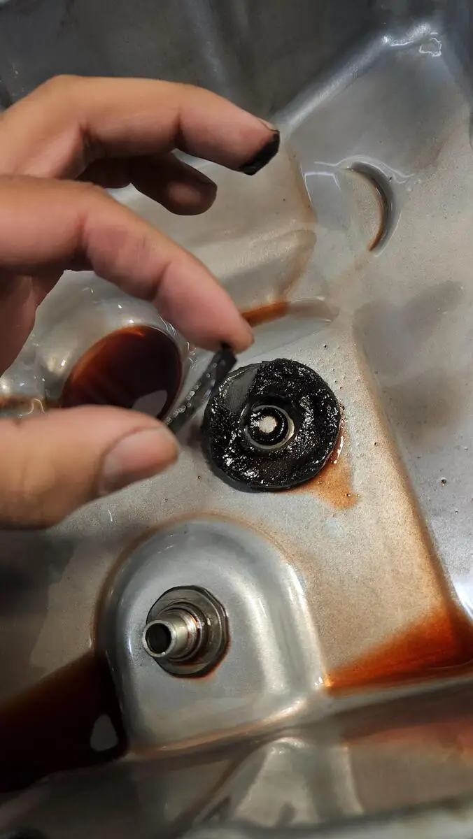

So my 03 Expo is causing me problems.
I spent nearly $4000 rebuilding the transmission slightly over 2 years ago. Everything was going good until recently, when I started getting delayed/hard downshifts (particularly when driving at slow speeds downhill, like 20km/hr on gravel roads sorta thing), and shifting into reverse is delayed (takes 3+ seconds to go into gear) and clunks hard when it goes into gear. Giving it a bit of gas will get it to shift into reverse faster, but then it clunks even harder. Sometimes it'll cause the OD off light to flash, and my bluetooth code reader is throwing code p0765 which is for a Shift Solenoid D circuit malfunction.
I went to check the fluid level over the weekend, and when I pulled the t30 plug out fluid started pouring out so I plugged it back up. I had been driving the truck a bit, so I think the transmission was too hot; there was gold flakes in the fluid though which concerns me.
This only happens once things have heated up, when its cold the transmission shifts into reverse normally.
The truck is sitting at a repair shop now; not the same shop as I had it rebuilt at, because I have since moved and that shop is no longer local to me. The shop just called me, and based on a test drive they think the torque converter is going bad.
So, based on the symptoms of hard downshifts and delayed reverse, plus the p0765 code does a torque converter sound like a likely issue? If not, any guesses as to what might be the issue? I was hoping it would be something like the solenoid pack needs replacing, would that cause my issues?
