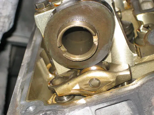

The accurate way to time the camshaft is to tighten the camshaft sprocket retaining bolt when the timing slot is below the axis of the camshaft and parallel to the head surface that mates with the valve cover.

thanks for the pic, I can tell it jumped a tooth because it had scuff marks on the valve cover from the chain rising over the teeth, I am glad you posted the pic for me I thought the slot was on the back of the cam gear now I see its on the front of the cam shaft. I wish i seen that before i put it back together!
