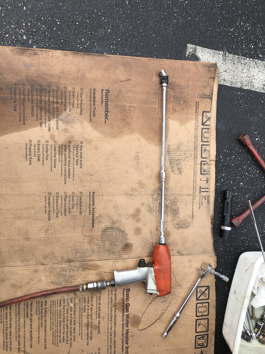

2002 XLT 4.6L 135K Silver, RR Air, Tow, All Original Owner. Got my starter changed. Starter worked fine but I thought the gear was not retracting properly because of a ticking noise near the bellhousing. Starter was not the ticking problem. Still a mystery. Only took 6 hours. 3 hours one afternoon..gave up..put it back together, then 3 hours the next day. Thanks to this forum there were many suggestions. This was the solution that worked after all on the top bolt. Passenger wheel off, Mud Flap off, About 24" of 3/8" drive extensions with a 13mm flex socket, behind the strut and a 3/8" Impact pistol. Top bolt was first one out, last in. Reinstall: Used scotch tape on bolt head to stuff it into socket, electrical tape on flex socket to minimize swivel. Got the bolt started by hand using the extensions only and finished with a 3/8" ratchet. Removal required the assembly pictured. ExpCon Oh Ya..Need to crack other two bolts loose before this Impact/Extensions could even loosen the top one.
