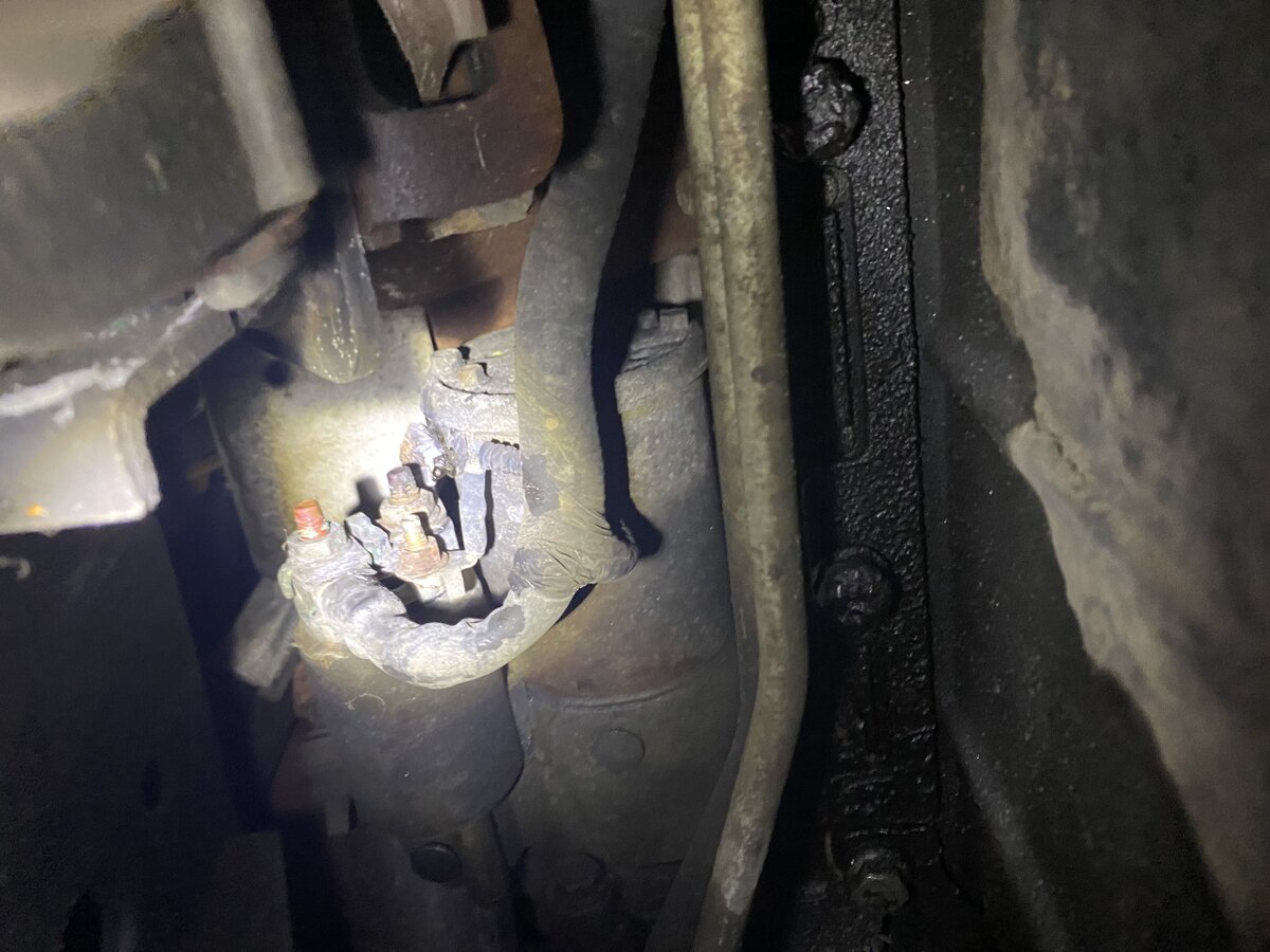

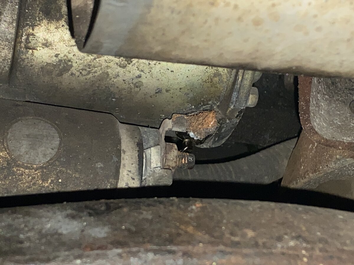

I’m pretty sure the starter isn’t suppose to look like that, right?
Also, I used a friends BlueDriver OBD-II to run codes and almost all codes are saying “Low voltage” or “Voltage out of range”
In all of my lengthy writing I have several times forgotten to say that it would be helpful if you could hook up to ODB-II and see if the truck knows anything about what is happening. Fortunately, your friend is better at helping than writing.
Have you tested the voltage on the battery? Obviously, if you battery voltage is low, get it on a charger.
I do think you should work on the wiring harness. You have 2 systems that are connected to that harness that are giving you issues. Even if the harness is not the direct cause, I don't think you will make progress until you can at least rule that out.
Once you know your battery is good and the wire to the starter is good, you can evaluate if the starter is still working or not. You can't check if a light bulb is working if the lamp cord is broken and you can't plug it in. Fix one thing and move on to the next, otherwise you end up chasing your tail.
I would also have a good look at your new S-belt. If for some reason it's not tight enough, that would explain allot of your issues. Your alternator will not put out enough voltage and your oil pump will not generate enough flow. You would get low oil pressure warnings and eventually your battery would get drained and it won't start. Maybe the new belt you got was a bit too long or to flexible, etc. Was it a Motorcraft belt? Do you still have the old belt to compare? Make sure that the new tensioner is pushed all the way up up and re-check the belt path over the idlers, etc.
I can't really think of any one other thing that would cause everything you describe.
