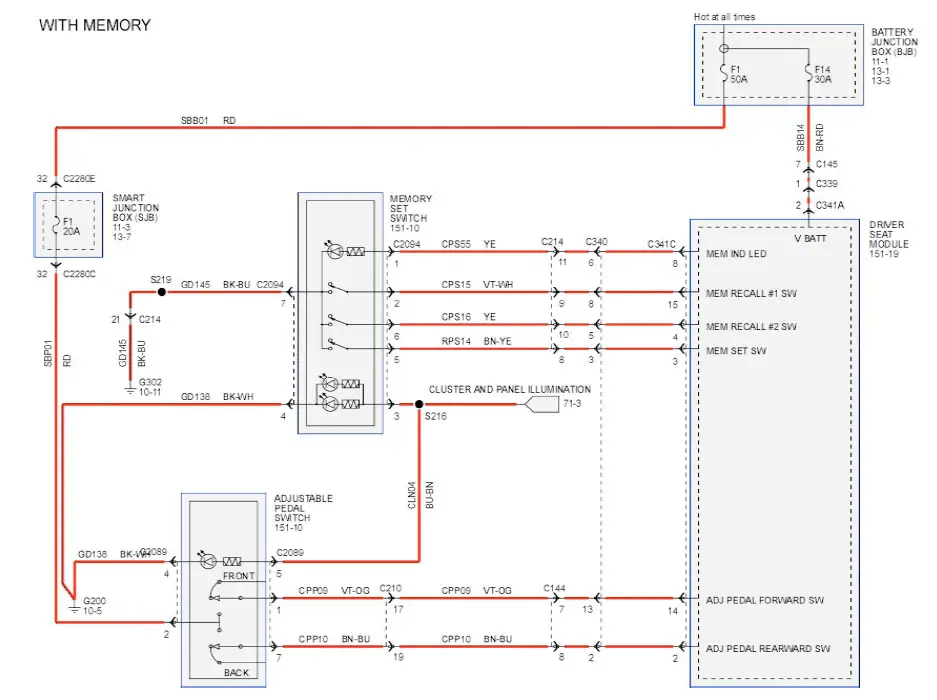

Not only my first post here, but my first Ford, and first SUV, though I've been driving Lincoln Town Cars and Mercury Grand Marquis for the last thirty years. Wife is tired of sedans, so I just closed a deal on a 2006 Explorer Eddie Bauer. We'll take delivery on October 11th, but for now it's sold.
Only issue I know of on the vehicle is the adjustable foot pedal isn't functioning correctly. The pedals move away when rocker switch pressed forward, but will not move back. When one of the memory seat positions is selected (can't remember if it was position one or two) the pedals move back all the way, as does the seat. I suspect it's the actual pedal position rocker switch, but that may be too simple. I asked if they could get that switch for me at their cost, which the salesman said he could do. I don't have much leverage now, because the deal is done, and they went as low as possible on the price. I don't see anything listed in their advertised specs for the vehicle about memory seats or powered pedals, so they're not really obligated to fix this as far as I know.

i'd just replace the switch. Sounds like the motor works both ways, not much to the system.

Bought the $29.00 switch, installed it, but didn't do the trick. Called salesman and explained situation. He balked at doing the repair, but offered to do a free diagnosis, which is scheduled for Monday. Hoping it ends up being a connection somewhere, instead of the Seat Memory Module or other component.

Thanks to this PDF version of 2006 Ford Explorer Mountaineer Factory Shop Service Manual Set + Wiring Diagrams, I was able to figure it out myself, and I didn't have to buy anything but the $20.00 PDF manual:
The wire labeled BN-BU from the "BACK" position of the Switch to the "ADJ PEDAL REARWARD" input of the Seat Memory Module was broken somewhere, so I jumped it with an additional wire.
