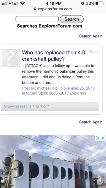

I posted a brief write up with pictures and bolt types and sizes in November 2018. If you don’t find it or have additional questions let me know
Here’s my post from November
View attachment 169062 Here’s my post from November
I found your post, thanks for the pictures of the bolts. What kind/type/brand of puller tool was used to remove the pully from the crankshaft? Also, i assume the same tool would be used to press the new harmonic balancer back on to the crank?

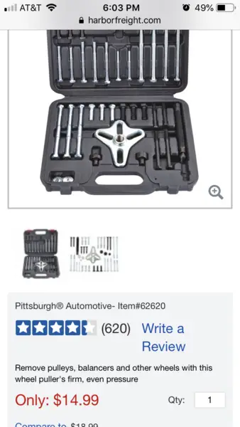

I used one from Harbor freight as well, it was borrowed so I can’t go check the part number but I can look on the site and figure out which one it was. If I recall it was less than $20.
As far as installing the new balancer, if you look at my pictures you’ll see the longer bolt that I used to pull it onto the crankshaft, the factory bolt is not long enough to catch any threads initially, plus it’s better to catch as many threads as possible when starting the installation. Once I got the balancer about halfway on, I backed out the bigger bolt and continued using the factory bolt.
I believe this was the kit I used, but all I needed out of the kit was the main yoke and the big center bolt.

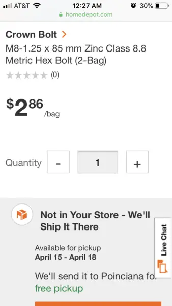

The bolts that I threaded into the old harmonic balancer are noted in my write up.Soak the bolt holes in penetrating oil in advance, and work the bolts in and out gently to clean up the threads
View attachment 169067 I believe this was the kit I used, but all I needed out of the kit was the main yoke and the big center bolt.
So basically the bolts that come with any of the harmonic balancer puller tools are useless. I would need to buy the longer bolt that goes into the crank and by the other 2 metric bolts that screw directly into the harmonic balancer itself.

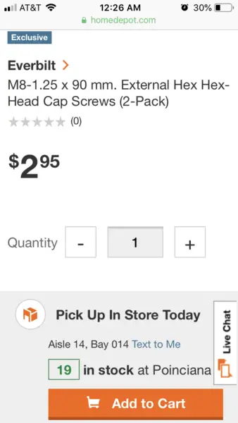

I’m sure they fit some things, but they didn’t include the size I needed, so $2 at Home Depot for the pair of bolts, but as I mentioned, try getting one size longer than I got... I believe the package in my pictures was 85mm... I’d recommend at least 90mm.

Yes, they screw directly into the threaded holes in the balancer, after a few sprays of penetrating oil. I’m surprised you’re not finding them...for me, I had a hard time locating the big bolt that threaded into the crank. Depot didn’t have that, I had to get it from a truck parts supplier near me
I used 85mm bolts, but they were barely long enough. I’d recommend the 90mm in the second picture

I went to another Home Depot and found the M8x1.25x90 bolts. I threaded them into the new balance to make sure they are the correct size. They only treaded a few threads in the hole. I’m hoping that’s enough to remove the broken balancer.
