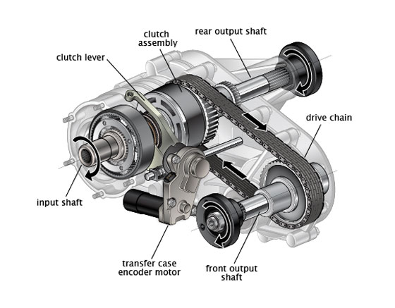

It would be easier to just swap the AWD t/case with a 4WD t/case. AWD has a clutch assembly inside that allows for power transfer between axles.

I don't think swapping an AWD transfer case with a 4WD case will function properly without doing a lot of other work. IMO, you would be spending way more money doing this than getting a salvage yard transfer case. There is only one mpg difference between AWD and 2WD 4.0L 4th gen Mountaineers. Even if you are able to convert yours to 2WD it won't improve your mpg much because the front drive shafts and differential will still be spinning and robbing power. What gives the one mpg improvement is that ALL the front wheel drive components are removed. You will still have the bulk of them in place. Why do you want 2WD so badly?

You might want to see if parts( driveshaft etc.) from a 2WD model can allow you to delete the transfer case and connect the transmission to the rear differential. IMO, this would be the simplest and cheapest way to convert to 2WD. Find a 2WD donor and see what the differences are between it an an AWD vehicle. It might be as simple as removing the transfer cast and installing the 2WD drive shaft.
If the output shaft is identical on the 2wd and 4wd, you could change the extension housing and driveshaft. I don't have that answer.
