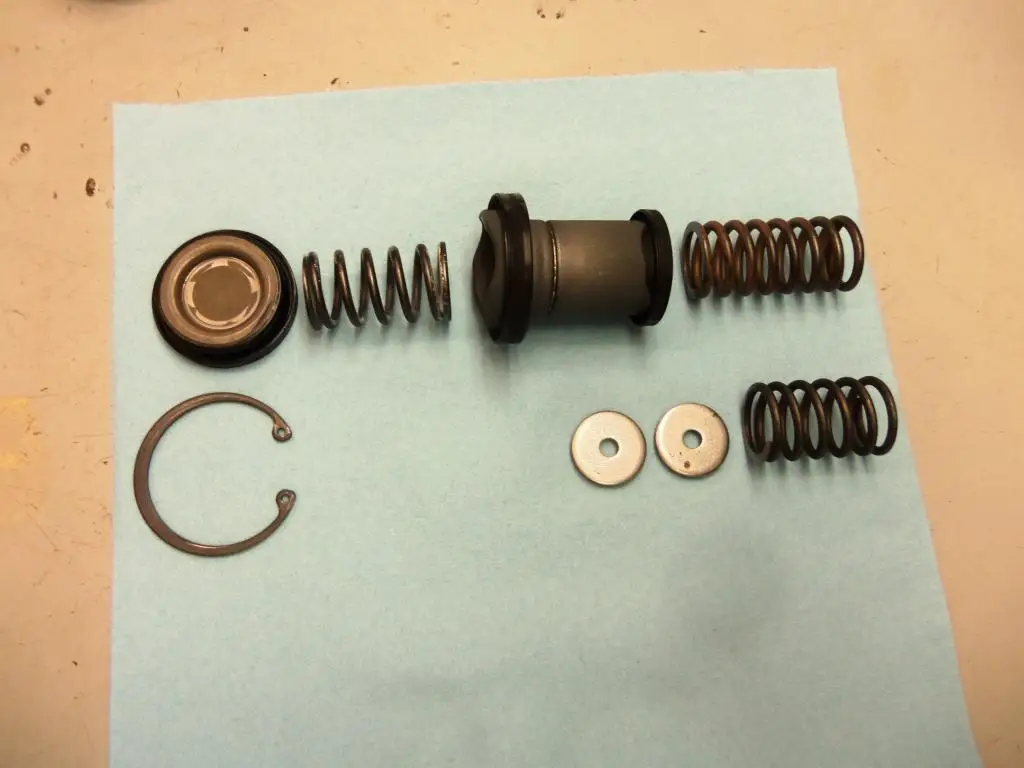

Here danlong,
From left to right (bottom to top as oriented in the transmission):
Snap ring and 1-2 accumulator cover
Shorter spring with traces of white paint
1-2 accumulator piston, in the orientation it came out of the transmission
Longer spring with traces of brown paint
Below them are the two spacers and spring supplied by Baumann to replace the upper longer brown spring.
Hope this helps!
Seth K. Pyle
Thanks for the response and pic Seth. I couldn't wait any longer and had to reassemble it on Sunday. Being that I couldn't find any instances of the white spring being on the bottom in various listings, I went ahead and assumed it was the original top spring. That said, according to the Baumann instructions for Setting "A", I used their supplied spring and 2 spacers in the top of the piston, then put the yellow (longer) spring back on the bottom. I can't say I've noticed any real issue, but the 1-2 shift is slightly firmer than I'd prefer at part throttle. Being that the springs are cheap from Ford, and it sort of looks from your pic that I may be wrong about my placement, I'm thinking that I'll order a new bottom spring, drop the pan and change it out just to be safe.
