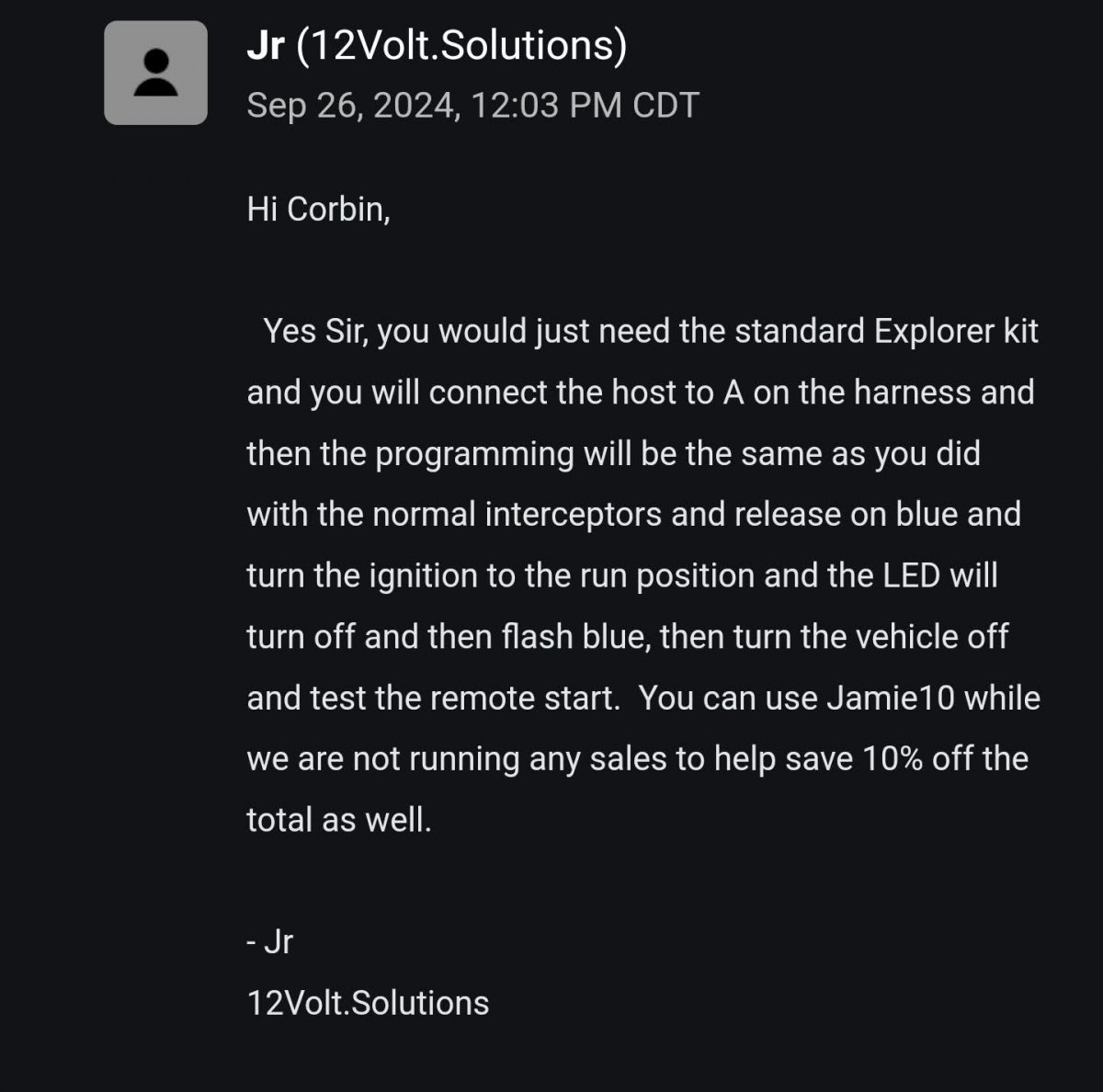

UPDATE!
Someone finally got back to me from the company. They said that the 2011-2015 module will work with the 2013 police model. See the attached image for the email I was sent.
(Transcript in case the image disappears in 5 years: "Yes Sir, you would just need the standard Explorer kit and you will connect the host to A on the harness and then the programming will be the same as you did with the normal interceptors and release on blue and turn the ignition to the run position and the LED will turn off and then flash blue, then turn the vehicle off and test the remote start. You can use Jamie10 while we are not running any sales to help save 10% off the total as well.")
